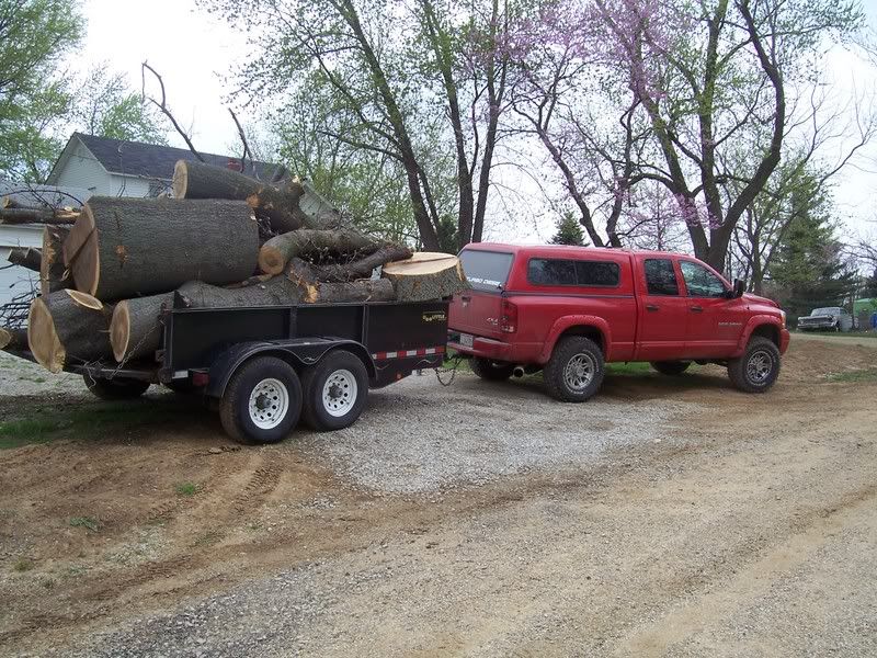

You should be all right as all the others say get some guages egt and tranny would be your most important with a basically stock truck. Some on here have pulled way more than that regularly. Sometimes with the 45' gooseneck and both pulling trucks plus dually going across scales hits 30,000 or more. Here is 25000 combined I had the other day with my 2500 CTD.
