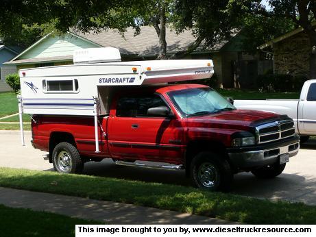

Went to Kansas on Saturday and picked up this little honey. This thing is a breeze to haul compared to the Lance hard side I had before. Not all of the amenities of home like the Lance, but very functional.
Now, my question: Anyone out there with a slide in with one of the alignment systems to help load and center the camper? Getting it off is not a problem, but since I usually load it by myself, anything that would make it easier would be a great asset.

Congrats on the new camper. I miss my old Palomino and have been really considering getting another one.
As for putting the thing on, I never really did much as far as centering, but after about the 100th time I backed up under the camper I would usually get it pretty straight. Just get used to cranking the wheel back and forth to pivot the truck to center the camper. Practice makes prefect I guess.
Enjoy the camper, and yes, those little pop ups are hardly noticeable after you've hauled a big full sided camper!

I have the Happijac frame mount front tie-downs which include centering guides. I balked on the rear centering guides as I didn't want any more holes in the bed. I still have to have a friend help me center this sucker as it's just easier. That being said,my camper tends to migrate and I stuff wood between the wheel wells and the camper's outer sides. Nice looking camper by the way! Make sure you're running "E" rated tires. I had a near catatrophic blowout on my '99 on the freeway using Bridgestone AT's,"D" rated. Never again. Bilstein shocks or better on all four corners,too. P.S. I removed the jacks as my when not in use for two reasons: 1,easier to see around with stock mirrors(I added Mopar tow mirrors) and 2,lightens up the rig as those jacks are heavy!

That Happijac system sounds pretty neat. I'll have to check it out.
This thing is so much lighter than the Lance, Squire 3000, it's unreal. The Lance weighted in at 2200+ empty, and this one it just a little over 1700. Granted, it don't have the inside shower and potty, but I didn't use those much anyway. The way my truck is equipped, I didn't even put air in the Firestone air bags, and it didn't have hardly any roll or bounce. When I get to the Colorado back country, I'll put about 30# or 40# in them.
10-4 on the "E" tires! In June, I blew a rear with the Lance on there. I'm running the Discount Tire, "C" rated Dominator's, which were OK on the highway, but I probably cut it on the back roads. Fortunately, it didn't blow until I was back on the pavement and only going about 30 MPH. I'm going back to Discount Tire next week and ask them if I need to throw the tire thru the window, or do we need to talk about it first. I'll probably go with the BFG, AT, "E" rated.
