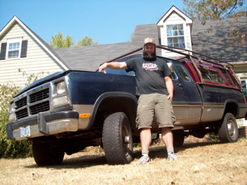

I am curious what I can haul with my new truck. It is 4wd. Does that mean i will need some sort of L joint because of the lift? What can reasonably haul at highway speeds.

If you don't mind, could you post a few more pictures of it?
I am a fanatic of these trucks.

That is really helpful information. I will hopefully get around to installing a gauge. Would that be some sort of transmission temperature gauge? Unfortunately I don't have a camera, those pictures were taken by my friend. Since I posted I found out that my buddy with the same truck had his rated by the state of NC. They do some sort of torque test. They said it could haul 12 tons, but I assume that is flatter terrain, well balanced 2 axel trailer with good brakes, and not at highway speeds. Thanks a lot yall, I owe you a beer.
At work I was using a 92 250 to pull a 40' combine header and it weighed in a 10,000lbs flat ground it pulled great but we had to go up a 7% grade....well going down the hill at about 60 and coming back up it was right around 35ish. So 24,000lbs I want to see a pic haha
