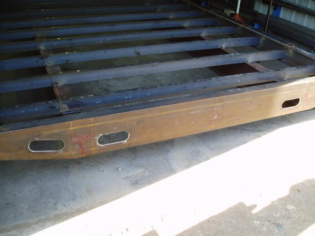

This is what I did for mine, they tie into the stake pockets and can be moved F to R and or onto the flatbed truck. The end of the ramps hook over the bed rails..

Great Idea having the ramps in the stake pockets. One thing people with fold up ramps have problems with is that the back of the trailer is too low and tend to bottom out.

Those are back-up lights. they are tied into the b/u circuit or you can flip a switch on top of the trailer junction box and they will stay on all of the time.. great for checking loads or backing up.
I also did a reverse beaver-tail on the trailer to cut down on the drag that you mentioned..
