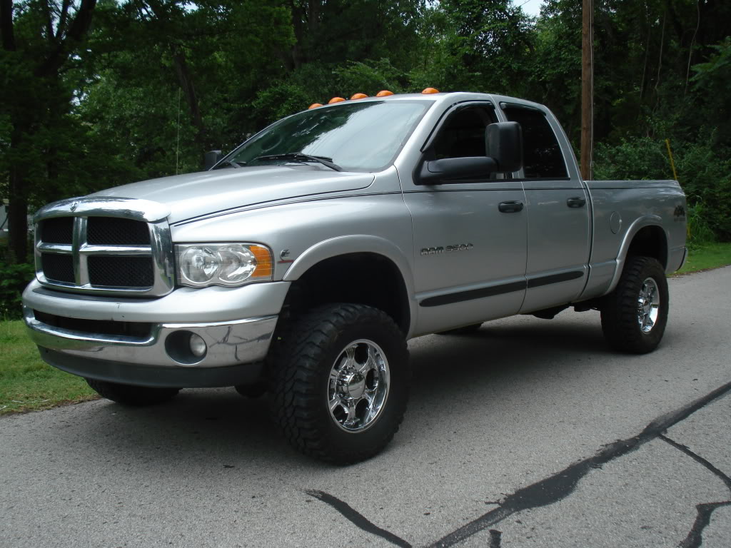

I would like to convert mine to a dually if anybody wants do some trading. I am out of St. Louis MO. I have an 03 3500 SWB SRW. My number is 314-226-6420 or my email is joe.difranco@yahoo.com I have all the tools and a 10K lift.
Old Jul 27, 2011 | 05:25 PM
Joey-D's Avatar
Joined: Jul 2011
Posts: 22
Can anyone chime in that has actually swapped axles shafts and not complete axle assemblies? I am trying to buy parts from REDLINEAR and he swears the outers are completely different between as srw and drw and not interchangeable. From everything I have read, the axle assemblies are the same between a SRW and a DRW except for
-Longer Axles Shafts
-Spacer ( I call it a spacer, Redlinear calls it the hub)
My plan was to buy axle shafts and spacers/hubs from Redlinear to convert my truck from a 3500 SRW to a 3500 DRW. Redlinear says these parts are not interchangeable. Has anyone actually done the conversion this way?
