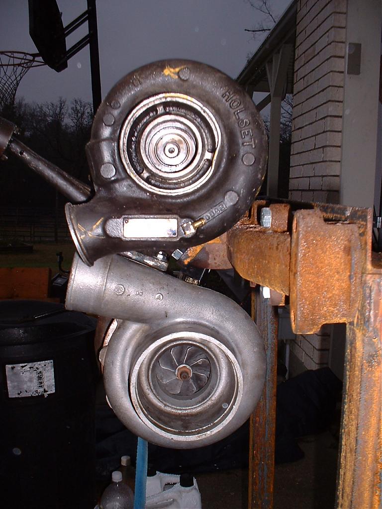

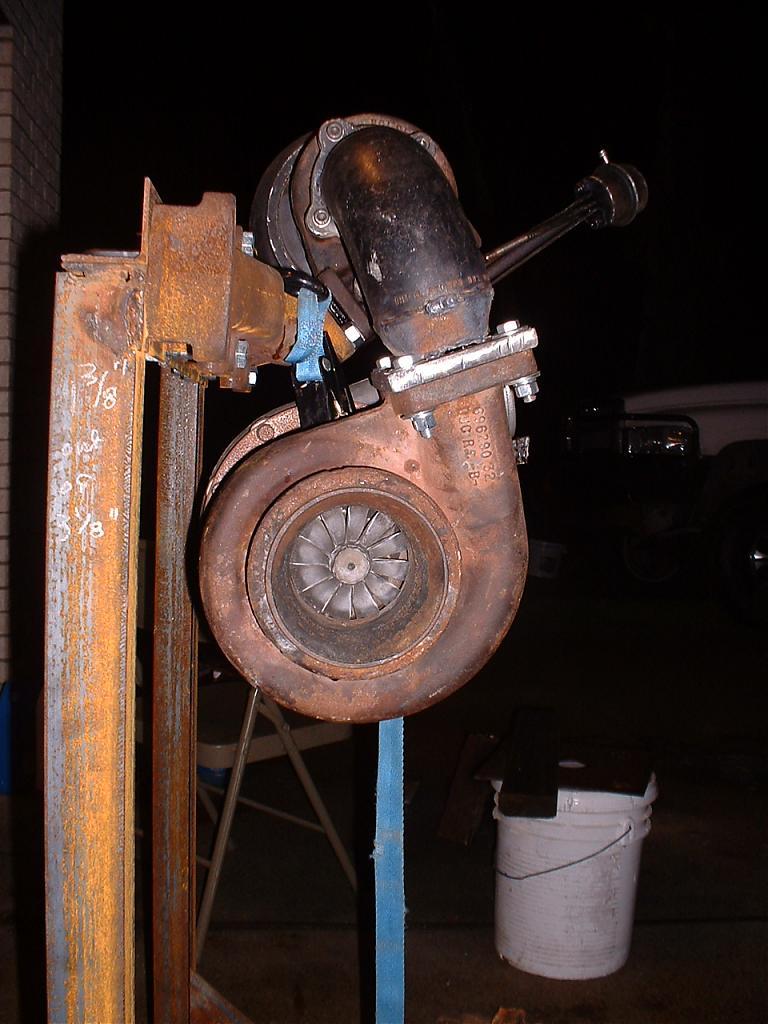

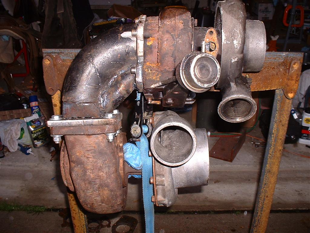

Muddin_dude06's Avatar
Posts: 901
From: Magnolia, TX
These might help, I still got a lot of work to do but for the most part they should be just right on my truck I am prolonging the finishing processes with this set because I am as broke as a joke haha
