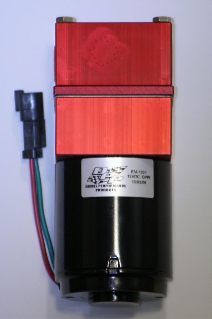

SO you have a HPFP then???
Yes, the one without all the fancy filters, the 95GPH.
