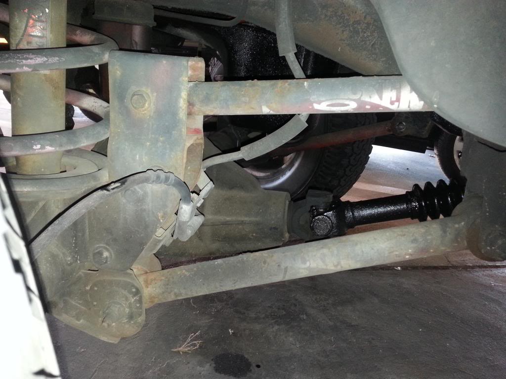

b) control arms: Top skyjacker is ~17" from bolt to bolt and lower is ~19.25" bolt to bolt but there is a relocation bracket on the top...I don't know what stock length is so just remove bracket and find stock length or if I can use these without the bracket for 2" of lift? (see pic below)

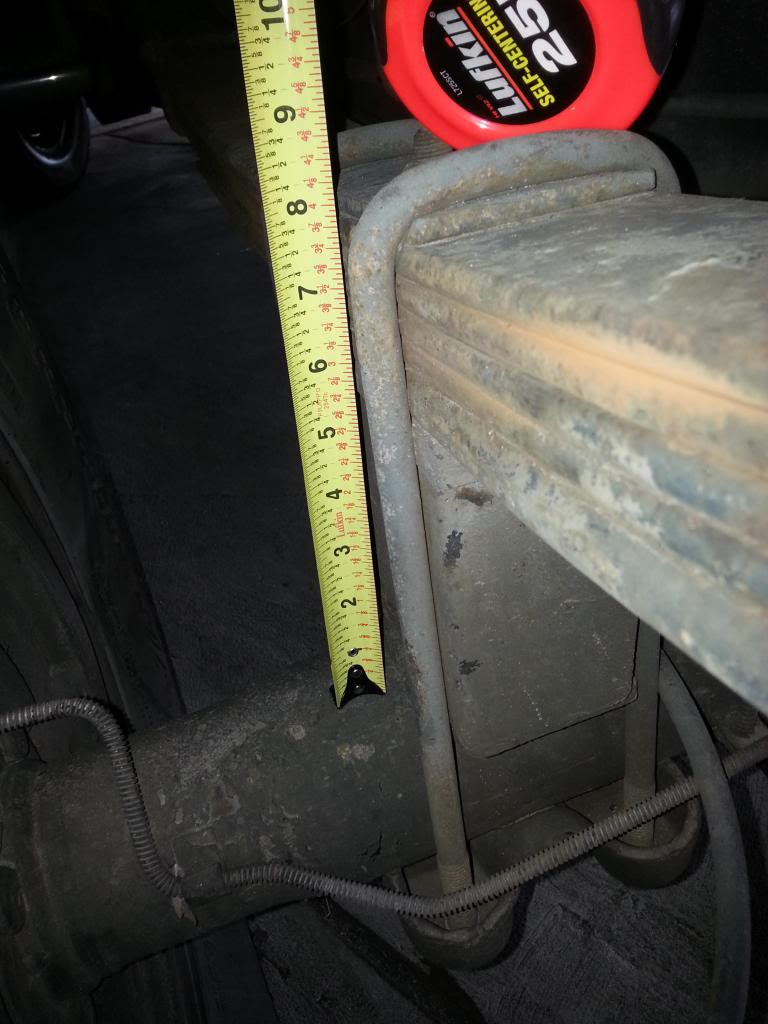

f) rear: (see pic below) Being as the lift came on the truck I don't know what is stock or what is added. any input on what to remove on the rear to make it stock height? I was told somewhere that the block is OEM and that it may just be one overload spring and possibly longer U-Bolts but I want to verify that, seems like alot on the rear.
