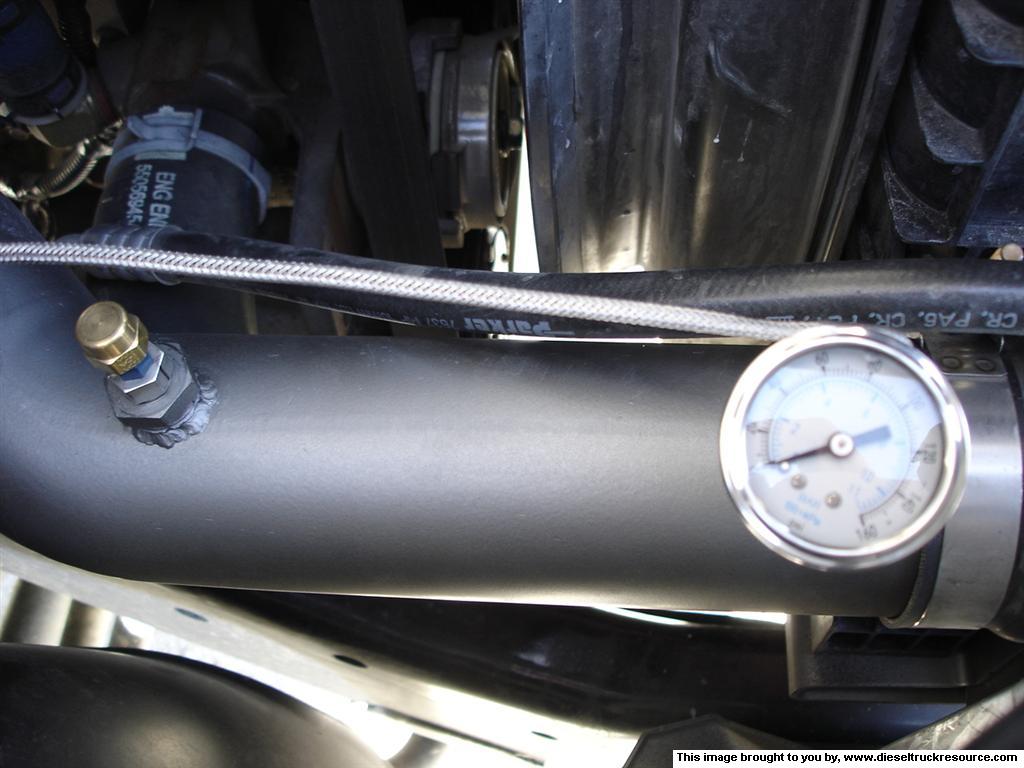

Thanks again, guys!
Thought I might as well show you some of the other gauges:
.... and the pre-CAC pipe:
