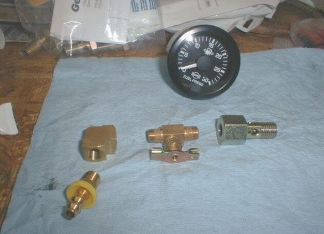

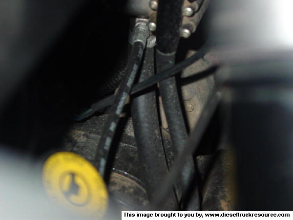

Good plan. You need a tapped Banjo bolt, some fittings, a needle valve, and some line.
Take your time and do it right - fuel leaking in the cab would make for a bad day. Also, protect the line where it passes through the grommot to go into the cab (a chunk of some sort of hose or tubing should do the trick).
This is on an 01:
