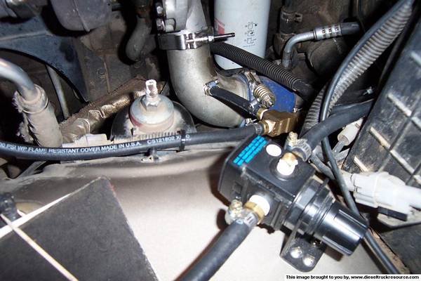

Originally Posted by POWERMAD
....does anyone have pictures of a wastegate installed and what kind of price for everything i need?
Here is my Tial 38mm Ext. Wastegate. It's welded onto the manifold and is controlled by a regulator giving from 20 psi to 'fully closed off' boost (62 psi).
Total cost in Dec, 2004 was $388.00 for fittings, regulator, hoses and W.G.
'Wasted' exhaust was ducted into down pipe... keeping excessive heat away from turbo.
Bottom pic is Wilkerson R08-02-F000 regulator setup.
Worked great...allowing me to take a non wastegated 425hp turbo up to 500 hp. without over spooling.
RJ
