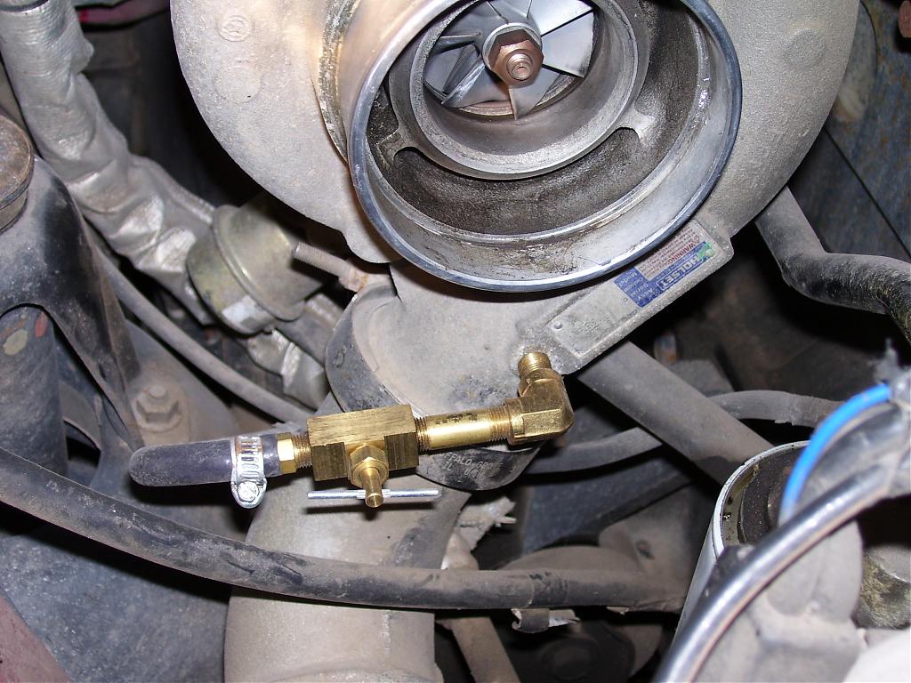

I could have told you how to make one thats more easy to adjust. I built my own for $11 with brass fittings from the local hardware store.

get three 3/8" NPT nipples,one about an inch long the other 2 as short as possible. Then get a 3/8 NPT needle valve and a hose barb that fits the line size to the waste gate, you'll also need 2 female elbows. heres how to put it together
1. thread the inch long nipple into your turbo.
2. thread on one of the elbows so it points to the passenger side of the truck
3. thread one of the other short nipples into the elbow.
4. Thread the needle valve on to the Nipple.
5. Thread the last nipple into the needle valve.
6. Thread the remaining elbow on the nipple.
7. Last thread the hose barb into the elbow and hook up the waste gate hose. Then open the needle valve all the way. I can upload some pics if you want them.

LUKE-MM-PULLER Will you please add pics I would like to take a look at how you built it to go along with your instucions thanks.

OK guys here they are. It looks different then the instruction say how to make it, but it should work. the way it is in the picture is minus one elbow & one nipple.

Thanks for the pics that helps.
So if you open the valve all the way you will see more boost close it and will be back to stock is that correct?

I think its the other way around. Just my guess, since you pinch the hose for more boost.

LUKE-MM-PULLER Thanks for all of your help I was able to get one built today
and went from 20 pounds to 30 pounds then I run out of fuel so I have to get the FASS pump installed.
