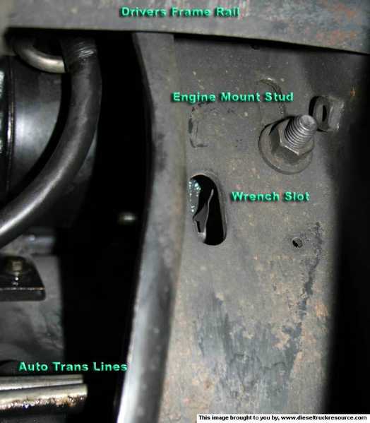

- Raise the front of the truck and support it by it's frame so as to put the front axle in full droop.
Originally Posted by torquefan
-Drain the coolant then disconnect the lower rad hose from the engine. I've found on a 1st gen truck, that hose is so short and stiff that if you try to stretch it that far (when you jack up the engine) that it will put a lot of stress on the radiator nipple.
- Remove the cooling fan shroud.
- Loosen the engine mount bolts (as needed) and remove the lower nuts.
- Lift the front of the engine till the rear valve-cover just kisses the firewall. Some even remove the valve-cover and lift a little more. I did, and lifted till the cab just started come up a little.
- Remove all the pan bolts except for that last bolt, rear driver's side. Leave it in a couple of threads. This will help with the following step.
- At the front passenger's corner of the pan, reach in between the pan and block, and remove the two bolts that hold the oil pick-up tube connection.
- Go back to the opposite corner and remove that one bolt letting the pan drop on to the axle.
- Just in front of the starter, there's one bolt that holds the oil pick-up tube's support. Remove it.
- Now, start sliding the oil pan toward the rear of the truck on it's way out.
- You'll need to roll over the crankshaft so as to move the connecting rod throws out of the pan's way as you complete removing it.

* The interior of the pan is Teflon coated, so you won't need to bother trying to get gasket shellac to stick a new gasket in place. It just plain won't stick.
* Be sure to put a small booger of sealant at the seam of the front timing case and the block (both sides of the block).
* The gasket is most fragile at the front, where it passes under crankshaft behind the damper. So be careful sliding the new gasket in with the pan and dinking with the oil pick-up tube.
