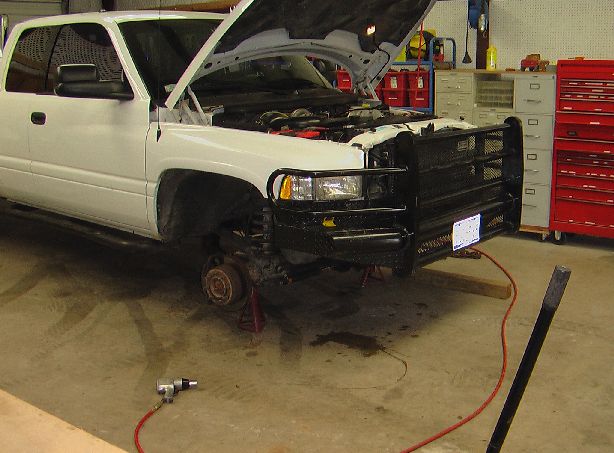

2. Truck at "working stance" only way to save my back!! (Hey Charlie, you notice all the labels on the tool chests, etc?? Figured you would appreciate that!! )

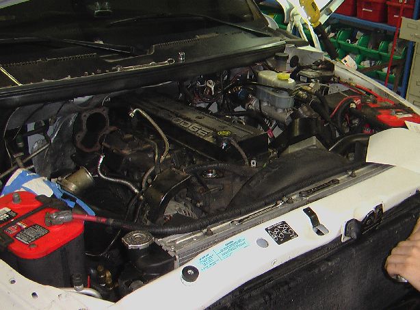

3. Starting to pull the twins apart!!

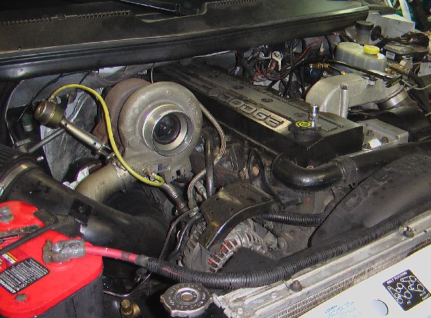

4. Secondary and Intake horn off

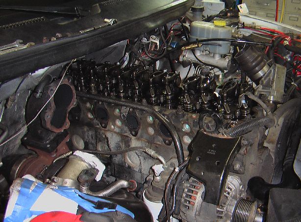

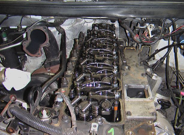

5. Exhaust Manifold and Valve cover off...

6. Injector Lines missing.. (In 3's!!!)

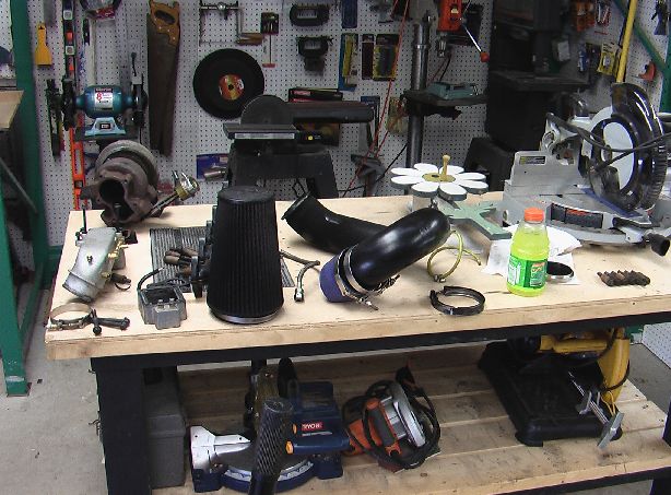

8. Head parts table.. (Now also contains, injectors, etc...)
9. Other parts table!!

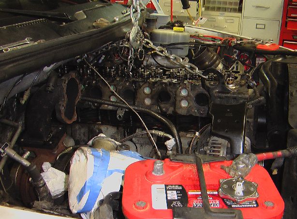

10. The head being hoisted... Bout 3 inches off the block

11. The First look!!
12. I was truely amazed at the zero wear!! cylinder walls all looked beautiful!! Looked brand spankin new!!
13. Another cylinder/piston before I cleaned them up...
"Zero Wear"! By far the most recurring comment from those of us unfortunate enough to have to get a look under the head. And that's at what...150,000 miles?
Fade94 please note; 6 yrs of use, 500+ hp, and VERY little wear. No real reason not to bomb... at least a little!
BN, Nice pics!
Is that the leak area.... between #1 & #2?
Any valve signature on pistons?
Find the push rod holes in the cowl? (didn't believe me, did ya)?

Ya it was just astonishing to see a brand new cylinders and pistons when I pulled the head 130,000miles young!!
Still not sure exactly where the leak was. I plan on taking the gasket up with me toFt. Worth on Monday to see what he thinks... Seeing that part of it stuck to the head and some to the block, I dont know if I'll be able to tell or not... Ya found the holes... Ur right didn't believe ya!! Had to bend one a bit to get #5 exhaust rod out Was hitting a lip in the cowl...
Didn't see any valve signatures at all on the pistons, will take a closer look later. Also didn't notice injector spray pattern like on that 1st gen? piston... Found that interesting as well...
