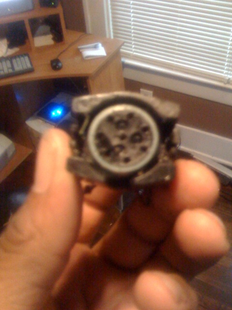

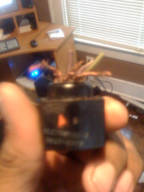

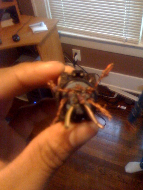

I need this connector asap if anyone has one or knows where I can get it please let me now I have not had any luck finding locally. Its for a 97 12v 4x4
connects to the top underside of trans
Attached Thumbnails Trans connector-trans-1.jpg   Trans connector-trans-2.jpg   Trans connector-trans-3.jpg

From the manual, it appears as if all the O/D transmissions used the same plug, thus any Dodge with a 42RE "should" have the same plug. This should open up a plethora of choices in local junkyards.
For grins, here are the pinouts.
Pin
1 Red, +12V from Trans control relay
2 Orange +5V from PCM, pin 31,C2
3 Black/Lt.Blue Sensor ground pin 4,C1 on PCM
4 Lt Green/White Governor pressure sensor signal pin 4, C2 on PCM
5 Violet/White Gov. Pressure Solenoid control pin 8, C2
6 Brown 3-4 Shift Solenoid control Pin 21, C2
7 Orange/Black TCC Solenoid Control, pin 11, C2
8 Violet Trans. Temp. sensor, pin 1 C2
You can check to see if that wiring/color holds true, but should be the same till at least 2001.

I got it ordered now do you have a diaghram of the location of the wires in the connector or a picture of one. I used qant to make sure everything is correct before I wire it in. The ones on the new part look a little off color wise from what I can tell from the picture.
Old Dec 31, 2009 | 08:03 AM
patdaly's Avatar
Posts: 8,372
Likes: 172
From: Streator Illinois
There should be numbers on the connector, pins should correspond to the numbers and colors above.
