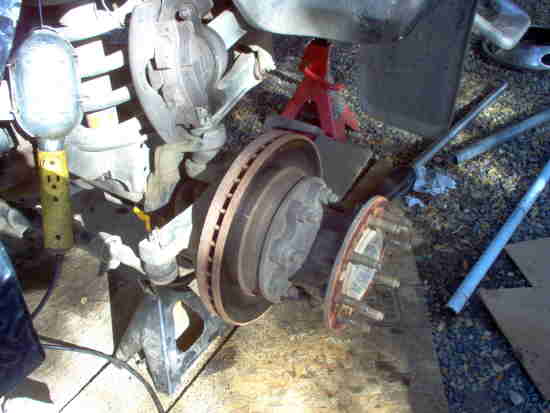

Here are a few pics showing the axle nut and hub bolts and rear of steering knuckle where the 4 12 point bolts are. The bolts are hard to see cause all the grease and crud before I cleaned them. Also I show the new NAPA drilled/slotted rotors and pads installed. A few weeks later the clutch went out and I had to put in my SBC 13 inch.

Here is a pic of how I wedged a pipe (wrapped with a rag between the ground and the wheel studs to loosen the hub bolts. Since I have a dually there is a dually spacer in the way. Your 2500 may be easier. An impact wrench would work for you. I did not have room for it.
