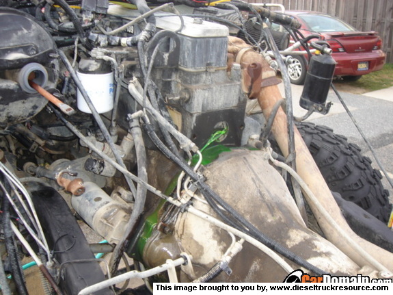

Get about 5' of 3/8 and 5' of 5/16" diesel rated hose, along with hose clamps. Take the lines off at the pump hard line and the return hard line, crawl under the truck and cut the lines right under the drivers footwell, and run the hoses. That will eliminate the factory rubber and quick disconnects, and should fix you up.
Infidel has a photo showing where the supply and return lines are at on a 12V.
