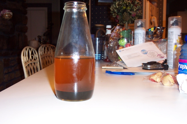

Well, just completed my first test batch. I have good separation. The picture is about an hour removed from taking it off the stir plate.

That's a Samuel Adams thats gone flat. Just kidding Arkapigdiesel how long did it take make that batch, I really no nothing of the process have not got that interested yet I guess.

Once you figure out the titration process, it's easy. I'm still in the beginning, but I made another batch today and it only took around 20-25 minutes to get everything ready to go and measured out.
Once everything is measured out and mixed, it takes about an hour for everything to be stirred together and allowed to "cook". I have a lab hot plate/stirrer that does all the work for me.
When everything is measured out correctly, I put my concoction in a sealed glass jar and make sure that the temp. is regulated in the 130-140 degree range, put my magnetic stir bar in, and put the glass jar on the hot plate and turn my stir adjustment up high. Nothing to it.
The hard part is making sure your titration is done correctly. It's hard to beat 85 cents per gallon and having a fuel that lubricates and cleans like crazy. Not to mention you aren't supporting the edit overseas.

Eventually. I still have additional equipment to purchase before I do so. Main thing is a Tuthill pump w/2 micron filtration system.
Keep in mind, that the sample you see above is the Biodiesel in crude form. There are still 3 wash phases and a drying phase that goes on.

Looks good, just gotta wash it and then dry it. Good luck with it, it can be addicting. KD
