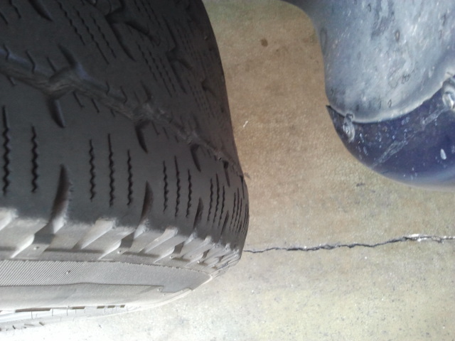

2 months ago I noticed the front end of my truck started to shake, I mean you go through a parking lot, take your hands off the wheel and can see the wheel rock back and forth shake. Looked at the tires and noticed a bubble in the tread. Took it over to Discount Tire and they replaced the left front tire no questions asked and rotated them at the same time. Yesterday, I was getting stuff out of the back seat and noticed the right rear tire (recently rotated from the right front) has a bubble in the same spot as the last one I replaced which was on the left front! New tire is on order also but it's making me wonder, I bought these 2 at a time, wonder if they had a bad run or what because right now, I'm not very happy with what was a highly recommended tire. On the plus side, I'll have 2 new tires after almost 40k miles...........

Got new tire #2 on today and did a thorough check of the other 2. Noticed that the tread groove in the outer tread had cracks in it. Will be watching them real closely. Here's a pic of the tire, keep in mind this one did the exact same thing the other one did, bubble in the same location of the tread and both tires were on the front and almost 40k miles on them. Name:  2014-05-05_155201.jpg

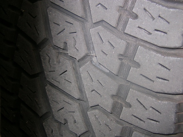

My Terra Grapplers are all cracked up. They were new in Nov '09 and have 38k (I just did the math and realized I've undercalculated on previous posts). I've had a problem with an out of balance tire in this set from the very beginning. I get new tires in the fall so I'm happy for that. Personally, I think it is Nittos in general. But the Duras get great reviews particularly. The TGs most people swear by. But I'm not a believer. Been having a lot more vibes recently. Ujoints or tires, just waiting for a loud pop

An update, both the other 2 tires started cracking in the tread so I went back to the tire store again. The same guy that helped me last time said they have to contact Nitto this time to which we both find out that Nitto just recently, like within the last week, issued a recall for my tires for separation issues. So apparently, there was a problem and now they're dealing with it. 4 new tires for free within 6 months, we'll see how it goes this time.
