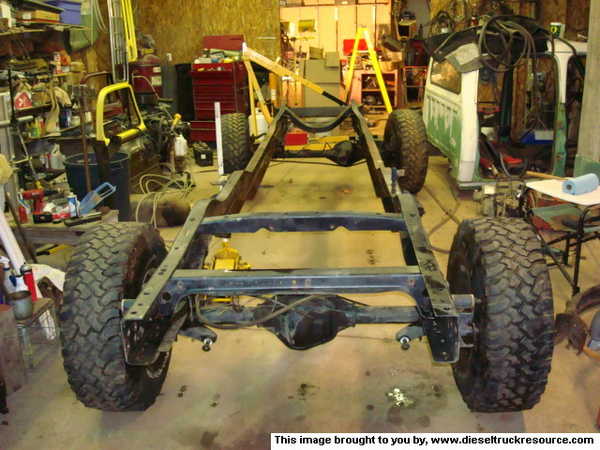

I got the frame stripped down to the axles. Next is wire brush and degrease to prep for new paint. Solved an issue with a large fuel tank/cross-member conflict.
Check updates in the blog link in my sig.

Was that fuel tank larger than normal? On my Crew Cab short box the tank is about 6 inches from that cross member.

I'm not sure which of the tanks you are referring to. The truck originally had just the cab tank that sloshed the gas back and forth behind the back seat. It held between 19 and 20 gallons. When I redid the truck in the mid nineties, I put the other tank in out of a wrecking yard gasser. It held also between 19 and 20 gallons. I do not recall the year or wheelbase of the truck it came out of. My big tank is out of my '92 donor ctd truck standard cab standard bed.
Your eighties vintage crew probably has the newer design of the two piece drive shaft. The front section of mine is about 20 inches long. The cummins trucks with two piece drivelines have a front piece about 10 inches long. The cross member I am having touble with now is the one that supports the carrier bearing. Yours id probably about eight inches closer to the front.

Your right. I used the drive shafts out of the extended cab doner truck that I had.
