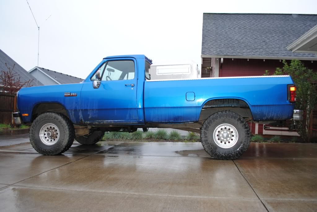

A. 1991 W-250 5.9bt Intercooled, 727 w/ OD, 4" spring re-arch, 215 tires, light pump mods, regular cab/long bed

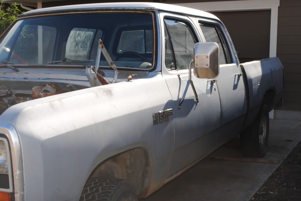

B. 1985 W-350 Crew Cab Short Box (has 360 4 speed (NP451) with a NP205 T-Case, Dana 60s full float.) ad removed

Hey , What is all of the wet stuff all over the first picture????? I live in Az and we hardly ever see any of it.. All B.S. aside , With what you are hauling , I would build a long box . Depending on how much money you have I would do a 5600 conversion, I think it is a much better trans, my opinion only....

Interior is gutted. Floor boards are in good shape, few spots of surface rust, some cracked sealant, but otherwise good shape. Aside from the ash tray and jockey box, the dash ( I was on my way to taking it out, until I learned from Bruiser's post that the windshield must come out, this is the first major difference I have seen from my old '77 Power Wagon) is mint. This gives me my first quandary, I was banking on the dash being gone and had foreclosed myself to using my good grey dash from the '91. Now which dash to use? I kinda want to convert the interior to gray, this would force me to paint door panels and swap in two shoulders belts and one lap from my truck, I would then need to find two more grey shoulder belts and one lap, hmmm.... I measured the rear seat space and think I can get away with using 91 bench. Total purchased 3 seat belts and a 60/40 bench from a second or third gen, and rubber floor mat. It did have a replacement mat that came in three sections and fit nicely, is there anyone still selling these?
I also attacked the wiring today, I have nearly the entire harness gutted. I didn't label or mark a thing; planning on using '91 harness. However, I did keep the '85 harness in-tact, I didn't go after it with wire cutters. The way I see it the only mod needed for the '91 harness is to lengthen wires for taillights and 7 way hitch plug. Anyone know better?

Pull Windshield
I would pull the windshield to check for corrosion and then re-install with a new gasket. I would probably paint the windshield channel with the new paint before installation. While the windshield is out, I'd swap out the dash.
Or better yet, pull the windshield and leave it out until the truck is painted. I've never liked the results of taping around a gasketed glass.
