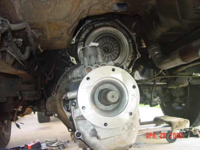

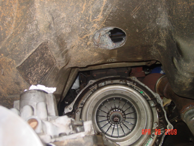

It has begun. I finally installed the fly wheel and clutch. Ive got the tranny under the truck but ran out of day light. I took some pics of the progress. I'm gonna try to mate the Ford master to the dodge slave. I have some used ones to try. If it doesnt work then I'lll go with the Dodge set up

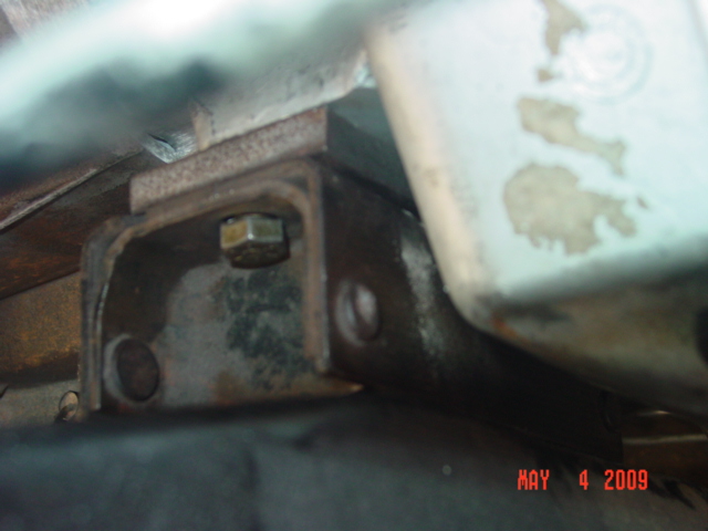

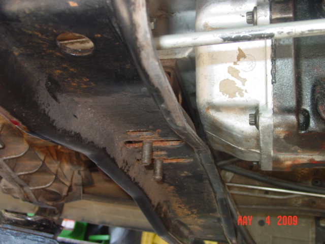

I've got the tranny and xfer case installed. Also had both drive shafts altered to fit. I was able to use the factory Ford automatic cross member. I had to make a 1/4 spacer plate and then used the Ford auto tranny mount. Turned out to be real simple. Next up is the clutch hydraulics. I took some pictures but they're on my computer at home. not much to see but I'll post them any way.

Here's what you need to know. Simple swap! I was able to use the Ford tranny cross member and the Ford tranny mount but used a 1/2 inch spacer/adapter as the bolts from the NV4500 and the Ford mount dont line up. I slid the cross member forward about 1 1/2 inches. The holes are already there so no drilling required. I used the Ford clutch master and a NV5600 slave cylinder. I had a hydraulic shop make a new line to mate them. They also installed a bleed screw at the slave cylinder. Bleed the components good before install.
I used a adapter from Advanced Adapters to bolt the Ford xfer case to the NV4500. List was $410 but I worked em down to $364 shipped. I would guess that anybody could do that as I'm thiking that they're probably not selling a lot of adapters because of the economy
I dont really have any more as it was quite simple with the exception of cutting the floor for the shifter. Lots of guess work
