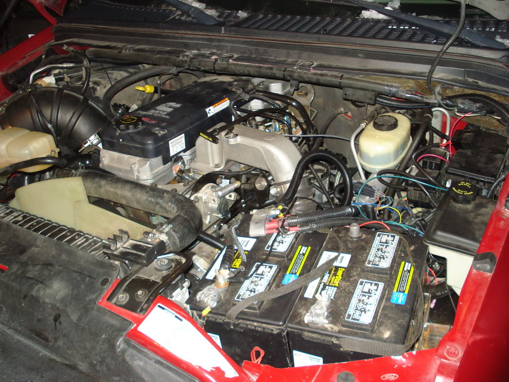

I've been able to drive it alittle more recently and there is alot of injector noise/rattle (I think that is what it is). It is very noticable when in the throttle . If I let off the throttle and coast the noise goes away.
What does it sound like when an injector goes south? Is there any test a scanner can do to determine if something is wrong?
A pic of the battery install... The cables I got from McMaster-Carr to connect the two batteries together worked perfect (not shown in this pic though).
