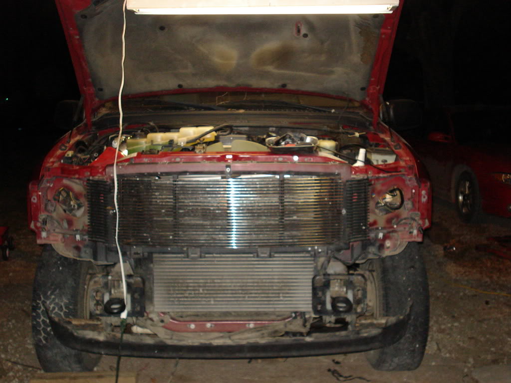

Almost finished!
Shift cable bracket got modified and mounted. Went ahead and used stainless steel braided hose and AN fittings from JEGS for the tranny cooling lines (turned out very nice). Had to modifiy the header panel slighly to fit around the dodge trans cooler. The front end is all back together now.
Still need to make a dual battery tray (for now I'm going to try one battery so I can drive it). Still don't have any gauges put in yet. Also have yet to pick up my new AC hose assembly and install it.
However, I got all the other wiring finished last night with the exception of the fan wiring.
I could of finished it and started it this morning but we got 1/4" of ice early this morning...
Here's some more pics...

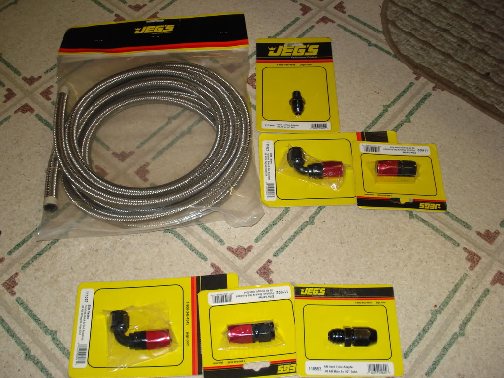

Here's a pic of the parts I got from JEGS for the trans cooling lines. I only replaced two lines (tranny to front cooler, and cooler on the block to the front cooler). I used the modified stock line from MASS Diesel for the block cooler to the trans (has the tranny temp sendor port already in it). I also kept the stock 1' rubber hoses with quick disconnect fittings on them that attach directly to the front cooler. One of them has a check valve fitting in one end.
In the picture below, the three fittings on the right go from the transmission to the front cooler line (check valve fitting). Part numbers are 110105, 111022, & 111002. The three fittings on the bottom go from the block mounted cooler to the front cooler (I kept 3" of factory hard line to go into the stock 1' hose with quick disconnect fittings), I could of removed this rubber hose and just went straight to the cooler hardline but it was hard to get to at this point. Part numbers are 111022, 111002, 110553.
All fittings are either for -8AN, 1/2" hard tube, SS braided hose or 1/4" NPT (on the transmission). I purchased 15' of braided hose, but 10' would have worked.
