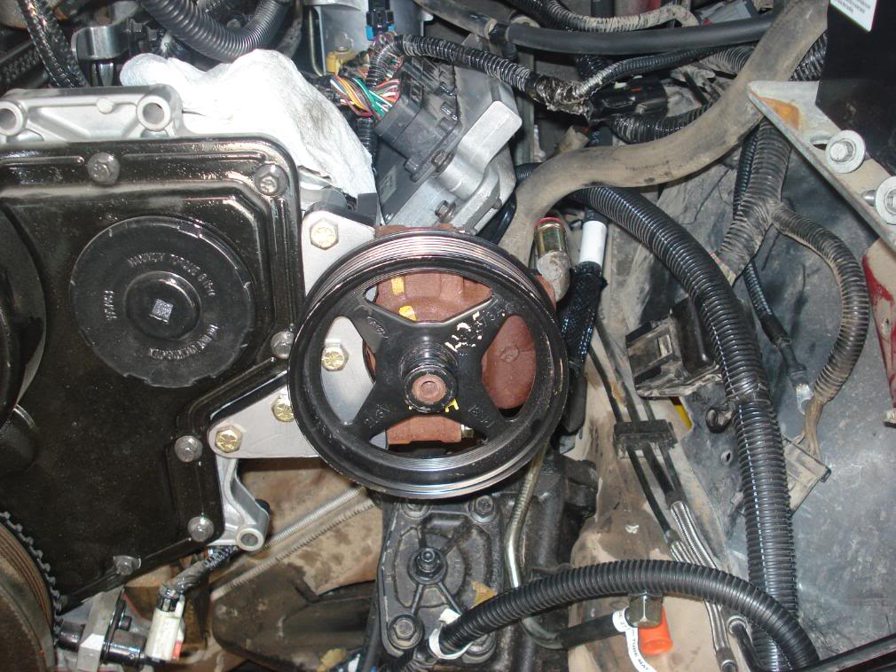

Got the ford power steering pump mounted using the Autoworld bracket, new lines installed. May have an issue with one of my ford lines at the hydrobooster (doesn't seem right), I'll find out when I fill the system and check for leaks.

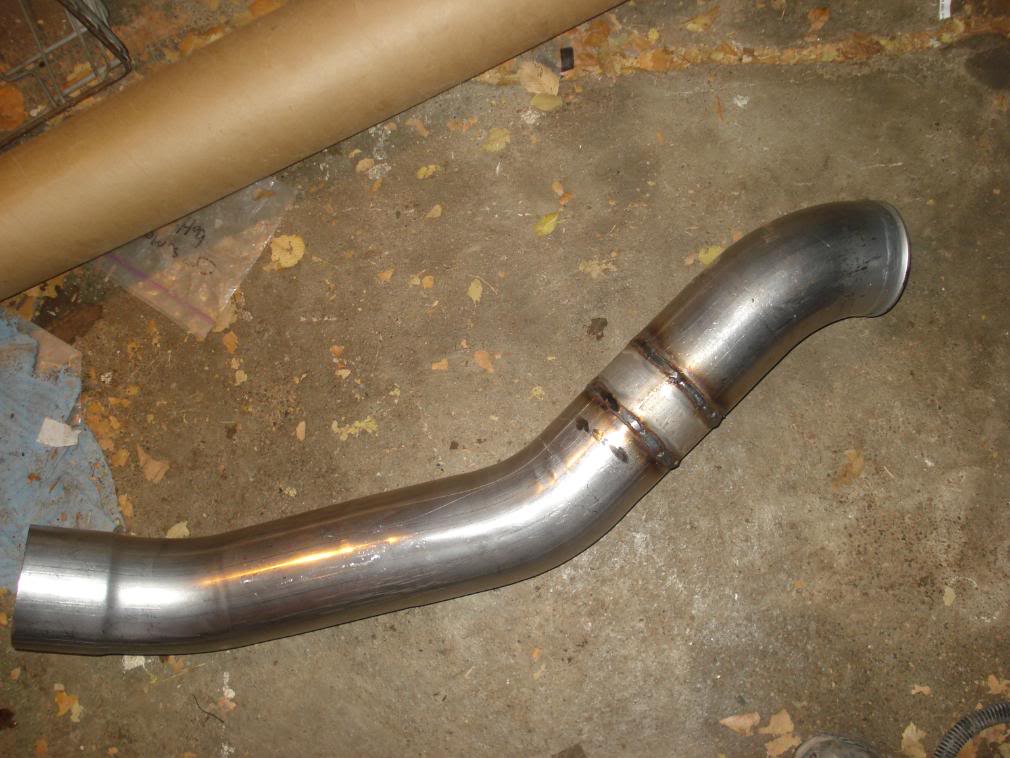

It's looks like I need to lengthen my downpipe about 2" on the downward portion to miss the ford body...

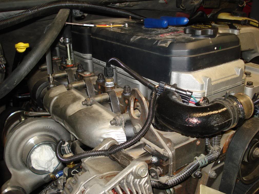

Finally some pictures... Ford ps pump installed on the relocation bracket (from Autoworld). Modified intercooler tubes and downpipe. These were a pain in the rear since I don't have a welder at my hose, had to measure first. Cut and tack weld. Trial fit, adjust, refit. Then finally weld them for good. Don't look pretty, but the flat black paint covers it up pretty good and it should function just fine.

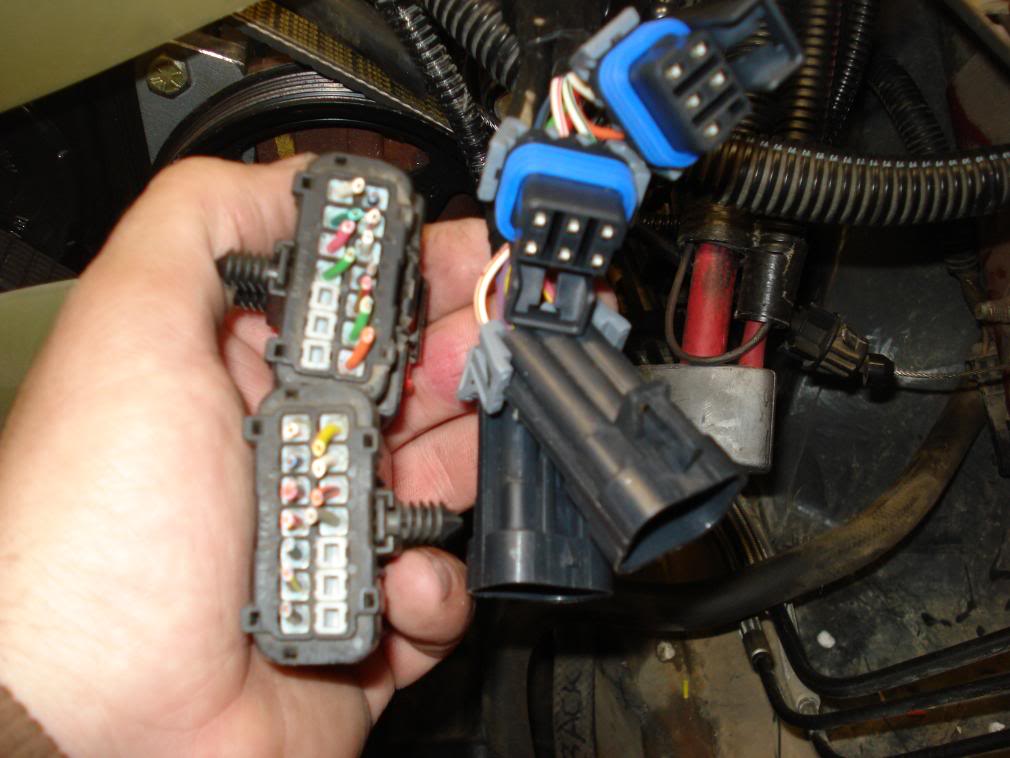

More pics...
I cut off the dodge engine wiring harness connectors, as I don't have the vehicle harness to match. I found some automotive style connectors online (which are weatherproof) that are working great so far for all the wiring. Have seals in the connectors as well as on each wire, shouldn't have to worry about bad connections anywhere.
Also attached a picture of the ford temperature sensor and oil pressure switch installed to allow the dash to work correctly.

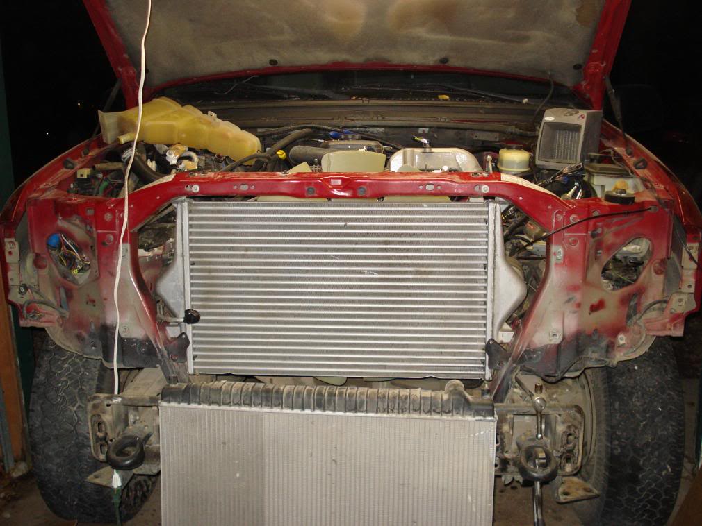

A few more pics, putting the intercooler in and the radiator. Mounting the dodge power steering fluid cooler (much bigger than the ford gas version). Still have to finalize the mounting of the dodge transmission cooler (plenty of room for it though).
