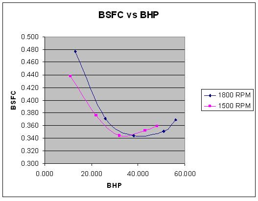

I just found some BSFC data for the 4B3.3-G1, it's an NA genset engine but I would imagine it would be pretty close to the B3.3's.
BSFC BHP 1500 RPM
0.359 48
0.352 43
0.344 32
0.376 22
0.438 11
BSFC BHP 1800 RPM
0.369 56
0.351 51
0.344 38
0.371 26
0.477 13
Looks encouraging that the min BSFC occurs at power levels consistent with highway road loads.

I wanted to see MotoBoyMatt's data in a more visual perspective. From my calculations I need ~40hp to travel ~60mph on flat road with no wind. Interestingly enough it looks like the higher rpm point would give better mpg's than the lower rpm point. At ~65 I need ~ 50 hp and again the higher rpm would give better mpg's.

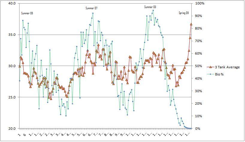

Filled up again. 38.4mpg. This is crazy. I was expecting ~5-8% improvement in mpg's by running on staight D2 compared to mostly biodiesel based on the studies I've read. It appears the engine will be exceeding this expectation. Here's a chart of my fuel economy/bio% over the last 3 years. The mpg's are a 3 tank running average to reduce the tank-to-tank randomness of the data.
