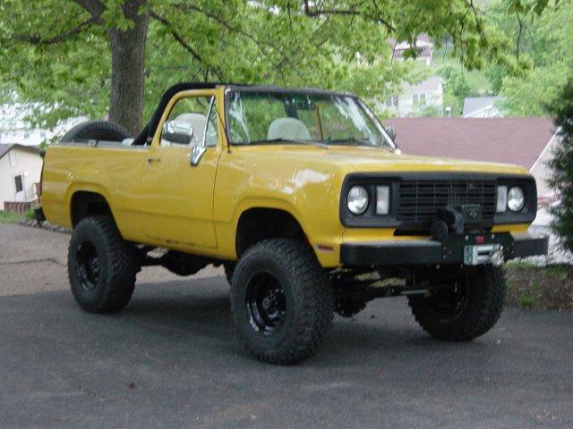

Hey Guys,
I'm new to the forum. But, not new to Dodge trucks, Jeeps, and the CTD. I have recently completed the 4bt conversion on my 77 Ramcharger. I have been building the RC for the last six years.
I started off by lifting it 5 inches and swapping in rebuilt D60s out of a 78 Dodge W300. While rebuilding the axles, I installed a Detroit Truetrac in the front D60 and a Detroit Locker in the rear HD60.
After the lift and axle swap, I discovered by running the VIN that my RC was originally a BB 440 truck. A previous owner had yanked the 440 and installed a 360. By the time I bought the RC, the 360 had become noisy and tired. That's when I got the idea of a 4bt swap into the RC and started researching and buying parts one or two at a time. By June of this year, I had collected most everything I needed to start the conversion and completed it by the end of September.
Here's what I ended up with...4bt, rebuilt 46rh, NP241, hybrid 205/241 shifter, and Dodge Intrepid electric radiator fans. A host of other mods and nickels and dimes as well.
I've discovered that the 4bt in stock configuration is a bit under powered. I'll be installing the 366 (3200 governor) spring in the VE pump and turning up the pump shortly.
Anyway, here's a pic and video.
Mike

Way cool! If I could have found a decent pop top Ramcharger, I would probably have mine done by now as well.
As it was, like you say, going topless is a MAJOR hoot, so when I finally found a 72 Blazer in my price range that wasn't slap rusted away, I changed directions.
The 4Bt would be just about right without the oversized tires, but yours looks so good, I would have done the same thing ( My Blazer is only running 33's ), and bumped up the power. Just for grins, have you driven it enough yet to get some mileage figures?

It took me four years to find a RC that wasn't rusted to bad. But, had I come across a 72 thru 75 Blazer with the full open top, I would have jumped on that too. Love those old Blazers.
I haven't done enough driving to calculate MPGs yet. I will eventually. But, even with 4.10s and the 35s, the rpms are high on the highway even in overdrive. I don't have a working tach yet. But, I could hear it at 65 and 70 MPH. I could probably run 37s to keep the rpms down. But, 35s are my limit.
