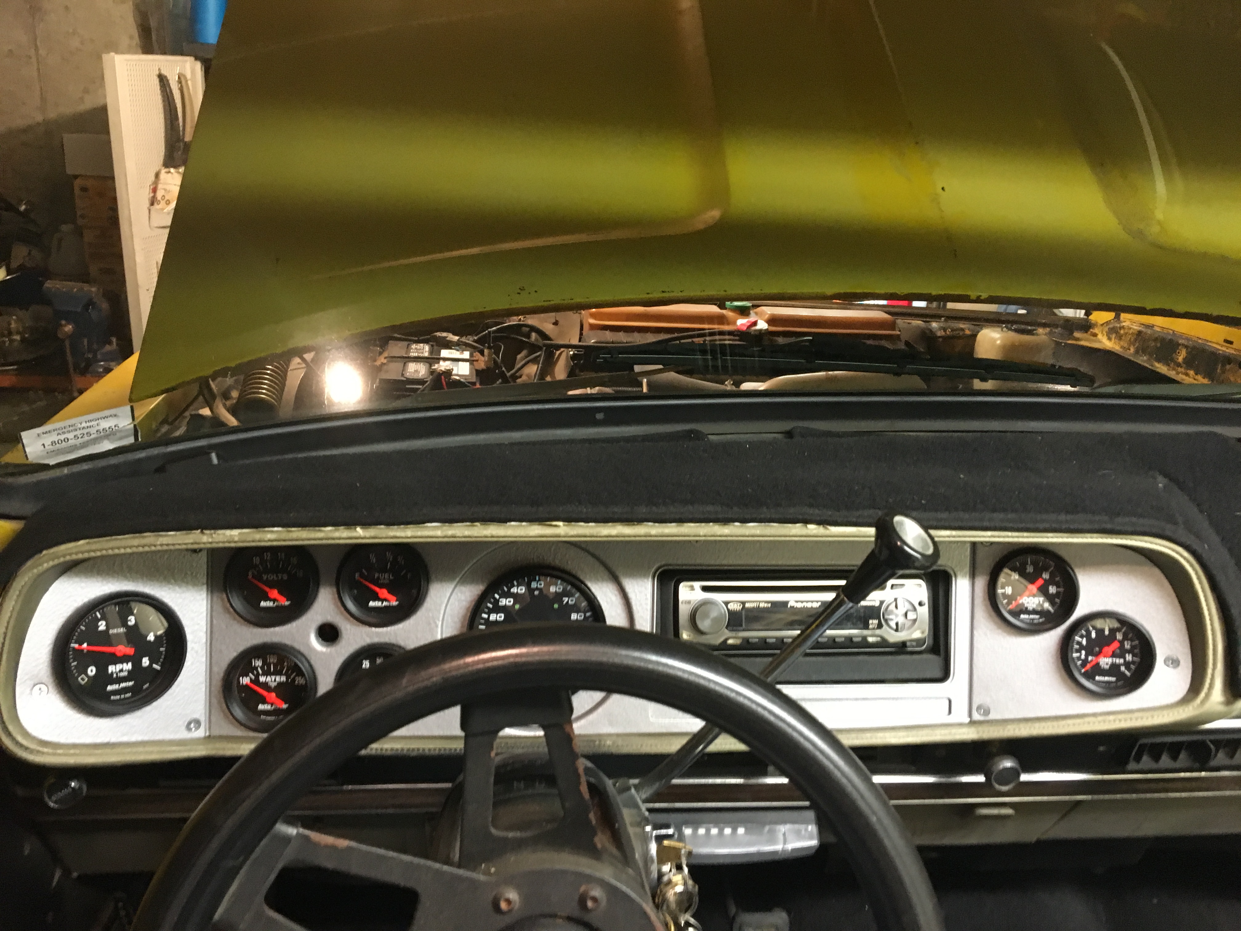

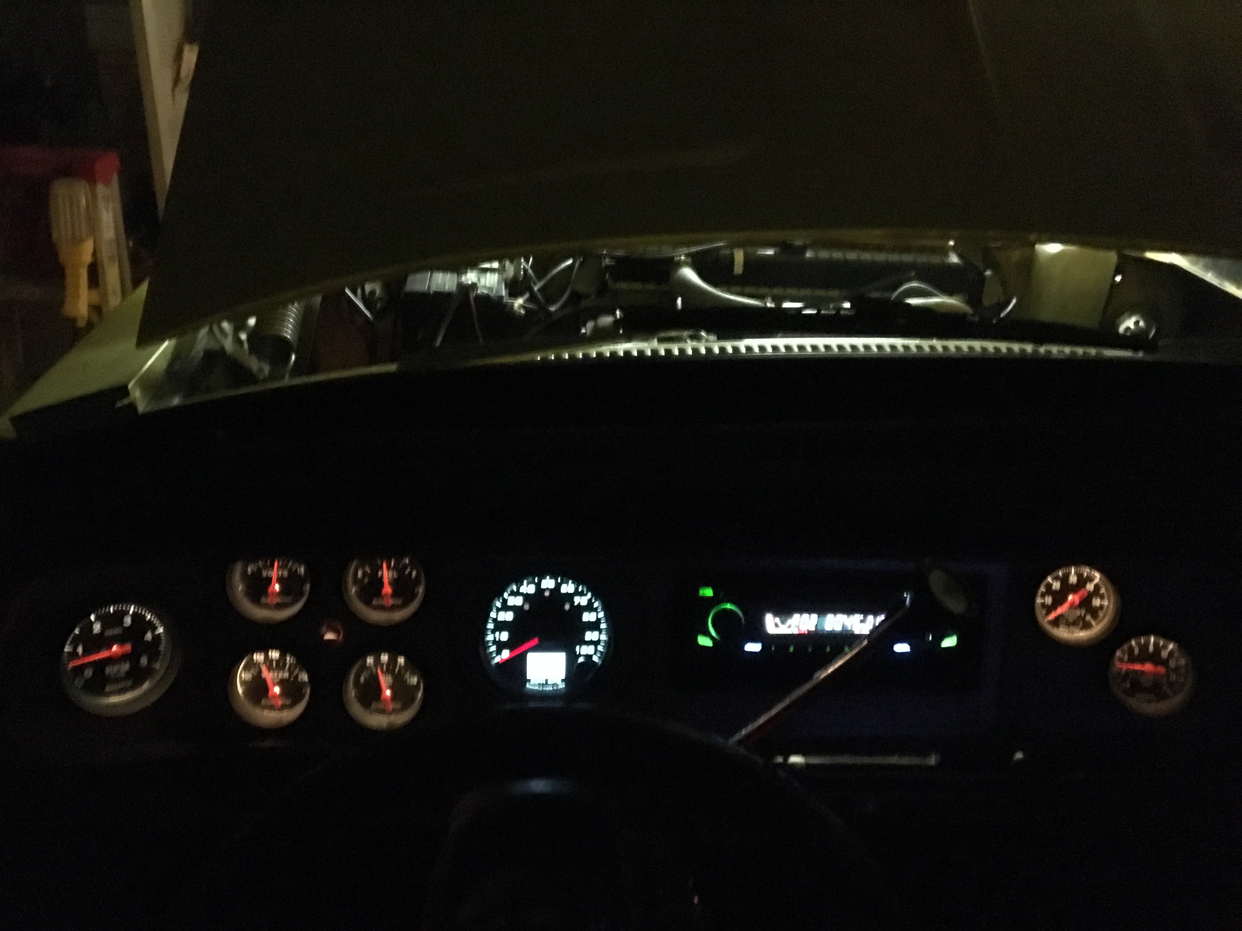

Hey Guys, it's been quite awhile since I updated my thread. Since doing the 4bt conversion, my next upgrade was to enhance the dash with new and additional gauges.
I wanted to keep the classic look of the 70s dash panel with the standard Oil pressure, Fuel, Temp, Speedometer, and replace the old Amp gauge with a Voltmeter gauge. And, add Tach (diesel), Boost, and Pyro (EGT).
I found a 70s dash panel for cheap off eBay, Widened the existing gauge holes to accept 2-1/16 gauges, and cut out the additional gauge holes at both ends of the panel, and repainted it.
I installed all Autometer gauges with the exception of the Speedometer. With the Speedo, I went with the SpeedHut GPS Speedometer to get an accurate reading without having to figure out the equation of speedometer gear, axle gear ratio, and tire size. It will work for me.
All gauges were installed, wired in, and all gauges work perfectly. I'm very happy with this upgrade.

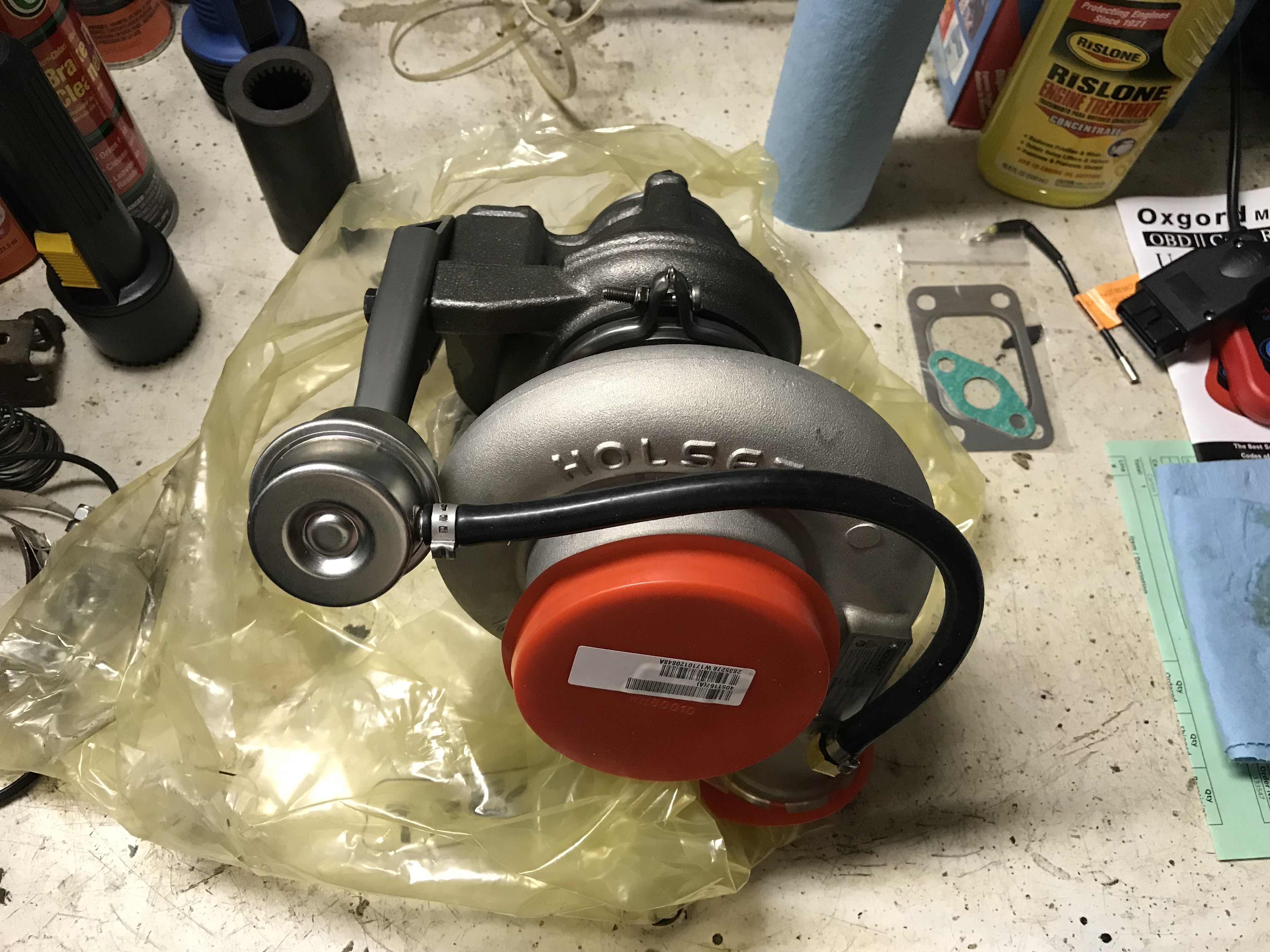

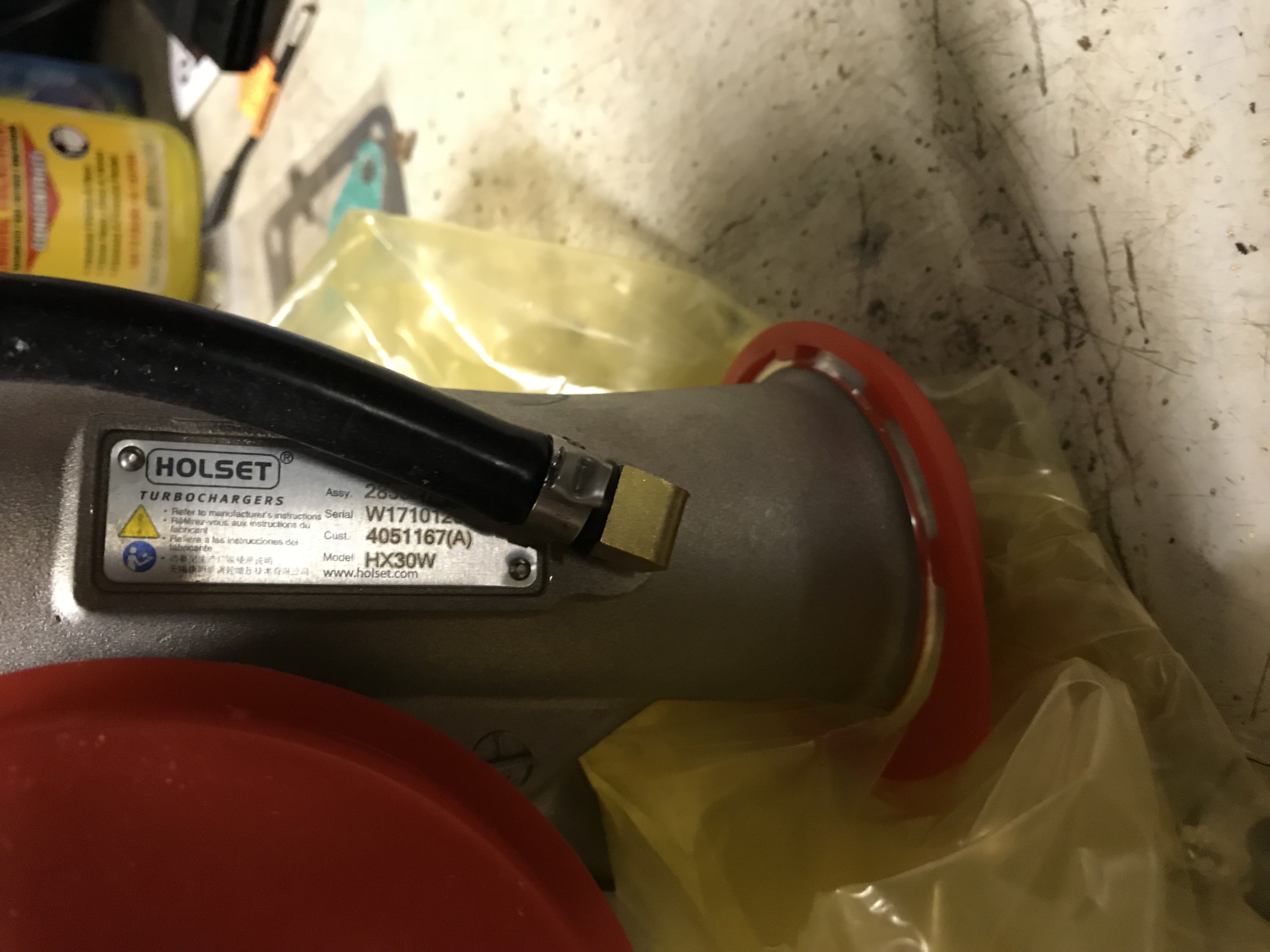

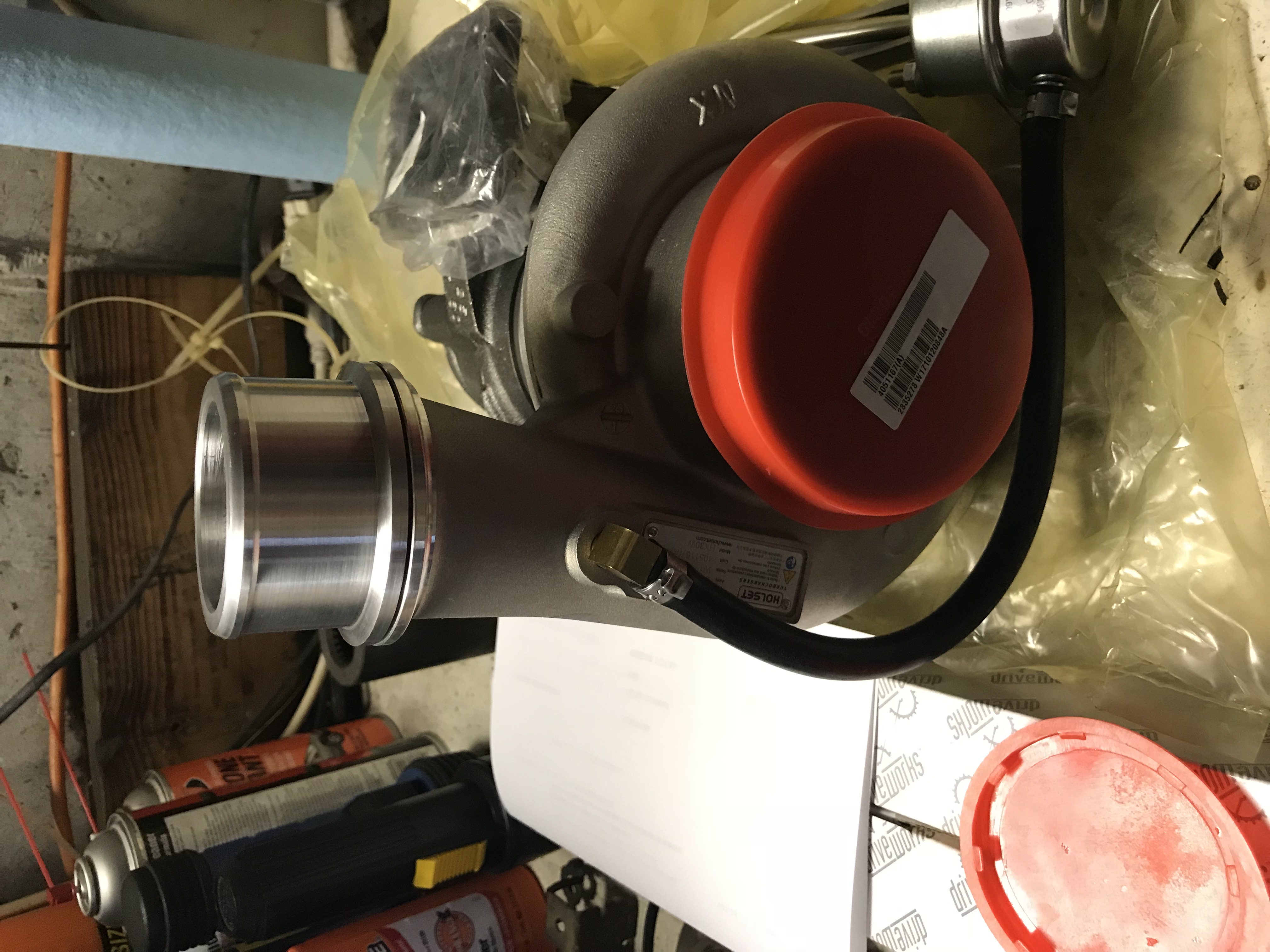

I received this turbo upgrade a couple days ago. It's the Holset Super HX30w. I have to do a few minor mods. But, it's going in. The factory H1C is fine for a 4bt powered Doritos Stepvan, But, seriously lacking in performance.
This is the turbo upgrade that I have wanted to do since I did the 4bt CTD conversion. It's finally happening.
For those that are turbo savvy, remove or keep the silencer ring? Any difference in performance? Or, is it just for the whistle?
Thanks, Mike

Old Mar 16, 2018 | 09:59 AM
patdaly's Avatar
Posts: 8,372
Likes: 172
From: Streator Illinois
I never saw any performance change, just a louder whistle........
Old Mar 16, 2018 | 10:05 AM
J10Mike's Avatar
Joined: Oct 2013
Posts: 70
From: St. Louis, Mo.
Did you install it on a 4bt? Which turbo?
Thanks
Old Mar 16, 2018 | 10:43 AM
Posts: 7,248
Likes: 2,875
I agree with Pat.
It just makes it more quiet, I don't think it offers any restriction to the turbos potential.
Old Mar 16, 2018 | 03:14 PM
J10Mike's Avatar
Joined: Oct 2013
Posts: 70
Got it. Thanks Guys.

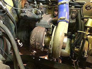

Super HX30w upgrade.

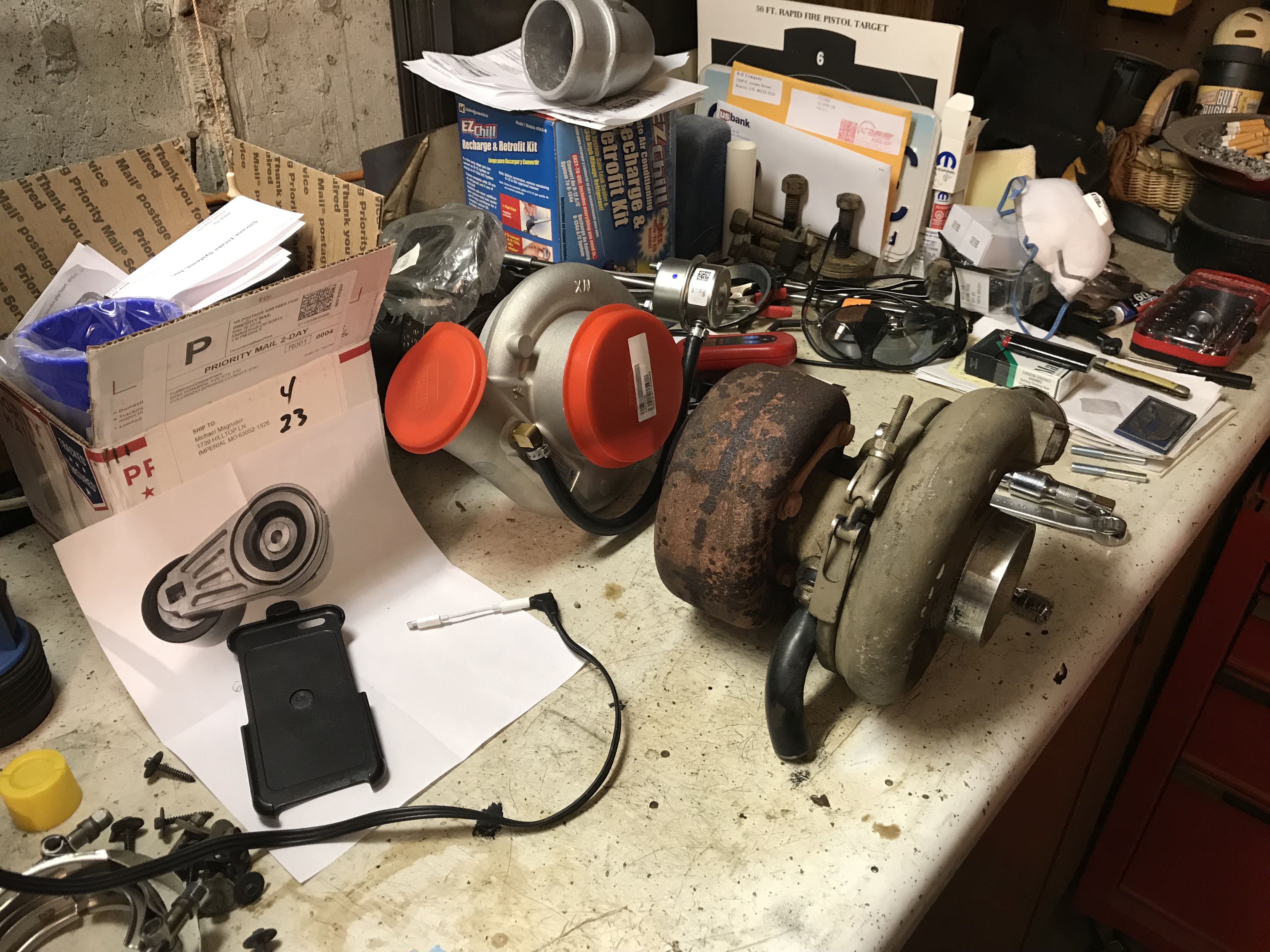

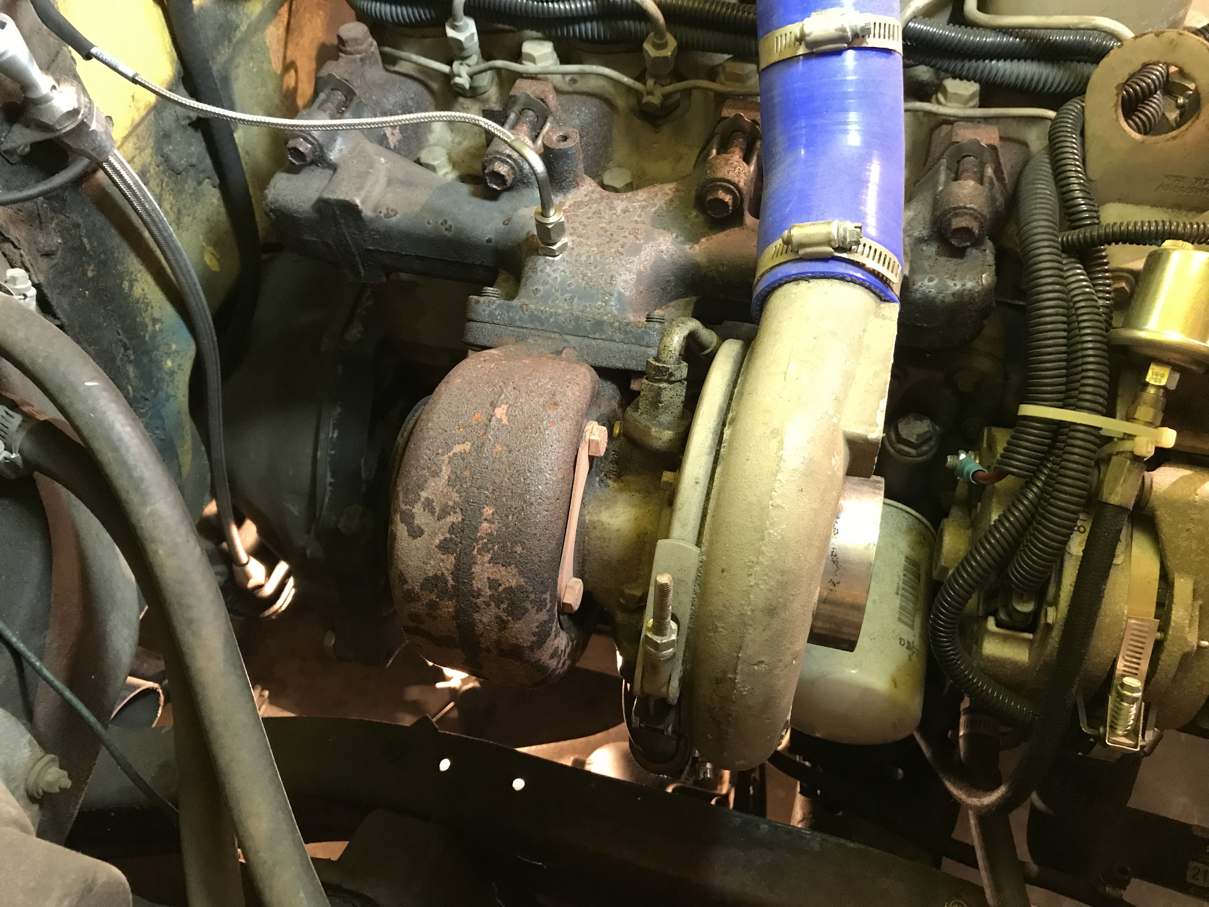

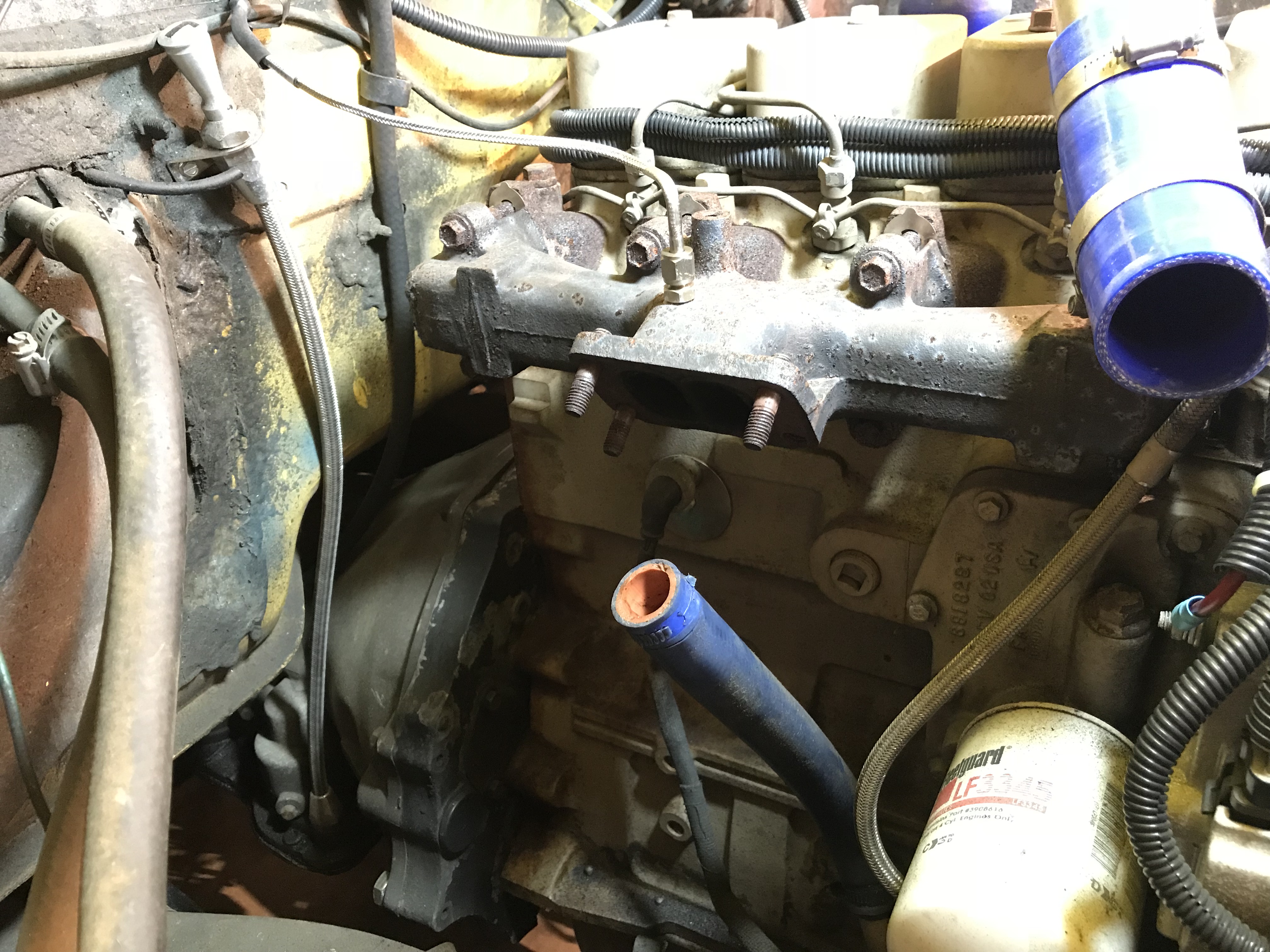

Hey Guys, this is where I'm at now. The Super HX30w is bolted down. Oil inlet and outlet is clocked vertical. Oil outlet silicone hose connected. Compressor housing is clocked so I could connect to the crossover tube. I Know, that's a lot of clamps within 10 inches. But, it's a variety of machined adapter, coupler, silicone reducer and hump hoses. And, at least these are genuine T-clamps as opposed to the radiator hose style clamps that came on the 4bt. It's not pretty. But, will work for now.
Just waiting on steel braided oil hose and already have the down pipe at the muffler shop to remove about 3 inches and re-weld v-band lip to pipe. I should receive those Monday or Tuesday. Almost there...
Well, I got the factory down pipe back from the muffler shop. What a difference. He cut out nearly 3 inches of pipe and re-welded the v-band lip back on. In the pic, both pipes are 89 thru 93 Dodge CTD factory 4x4 down pipes. I wanted to show the difference. And obviously, I wanted to use the pipe with the heat shield. That modified pipe should tuck in nicely between the turbo and firewall with a little room to spare.
The shop didn't charge me a dime. Mainly, because he didn't want to guarantee the pipe angle and fitment. He just said if it works, bring him some Bud Light...LOL. He's also the same guy that installed my new exhaust in the RC 5 years ago after the 4bt swap. So, I've gotten to know him fairly well.
Almost finished with the HX30w turbo upgrade.
