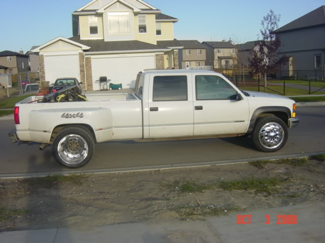

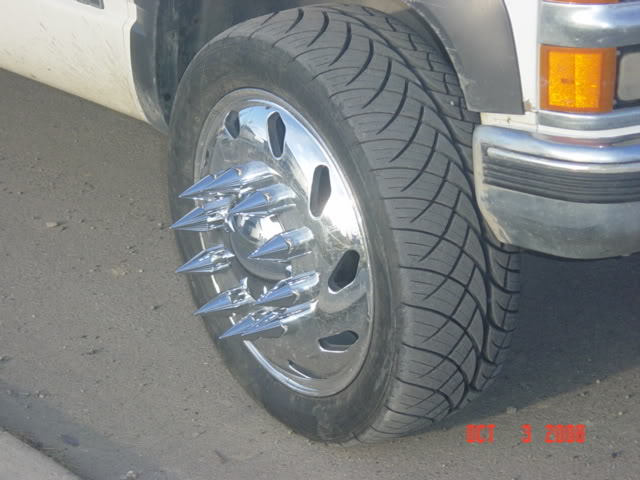

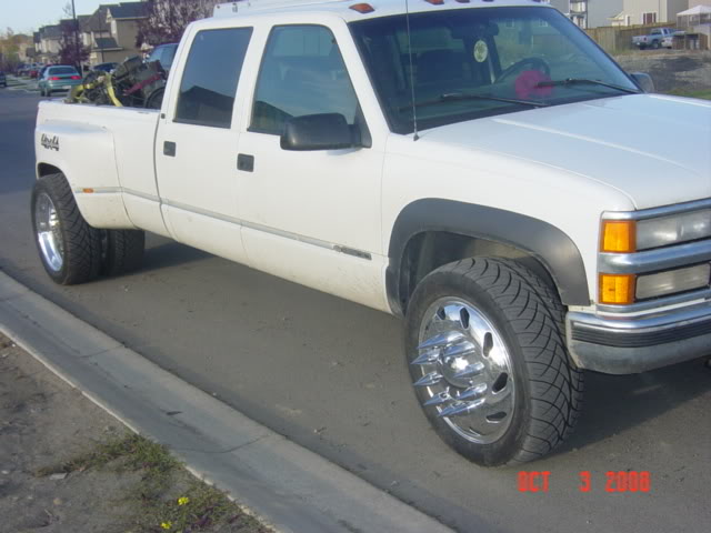

rides great. no balance done on the rim and tires. no vibrations. smooth ride, you can definately feel the unsprung weight difference though. seems to make the truck ride smoother so I can't complain.
Since I can't leave anything alone for 5 minutes....... Heres the Import shredders.
still looking for the correct cover and caps for the rear though

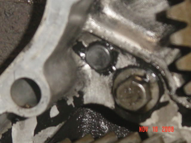

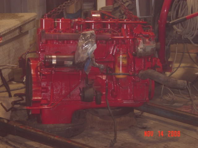

well gues I haven't updated in a while......not driving it yet. too dec off for holidays and to re-engineer the drivetrain. to a 2wd 47rh and a '70's Ford divorced NP205. built crossmember from the former steady bearing crossmember.
Old Feb 1, 2009 | 02:28 AM
  #57
1-5-3-6-2-4's Avatar
Posts: 3,142
From: Okotoks AB
made smoke tonight. lots of smoke now to get driveshafts and button up Everything!

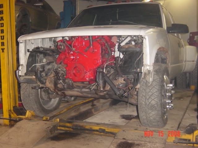

From: Winnipeg, MB, Canada
Looks awesome!
Did the engine drop in without having to modify the oil pan? Pics of this would be great.
I have a 92 K2500 that I am gonna drop my Cummins into.
Glenn
Old Feb 3, 2009 | 08:39 PM
  #60
Posts: 3,142
From: Okotoks AB
i didn't touch the pan rail. I trimmed the bottoms of the Gm isolators to fit the pan rail in between. and swapped some pan bolts around for correct length clearance.
cost.......not cheap. I'd have to run up the tab to know for sure but its up there. though I've been compiling parts for about a year prior. and I'm not just going to drop the engine in and call it good. it would be far cheaper to do that for sure.
its something like this that keep me from buying a "new" truck. so if I spend $5,000-$15,000 on a swap and truck interior overhaul and paint job. thats a far cry from 30-50K for a much newer rig.
I got the '95 donor dodge for $2000 whole truck. plus 22 hours round trip to get it. few hundred for conversion motor mounts. then its all the fitting cutting and time. that theres no price for. its only time. plus whatever you decide to do with the ret of the drivetrain matters too I guess. it would have been cheaper for me to keep the NV4500 that was already in the truck behind the bigblock. but I wanted an automatic this time for this truck. and my donor had an auto. so I went that way. that was a hard road fitting that all in with out a suspension lift or body lift, and working around the IFS crossmember.
Theres cheap ways to go about it, but depends on what you want in the end and what you have to start with. I for sure didn't go the easy way.
