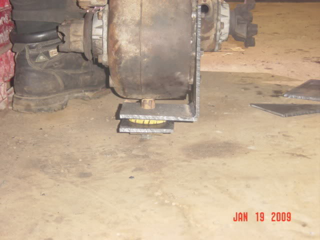

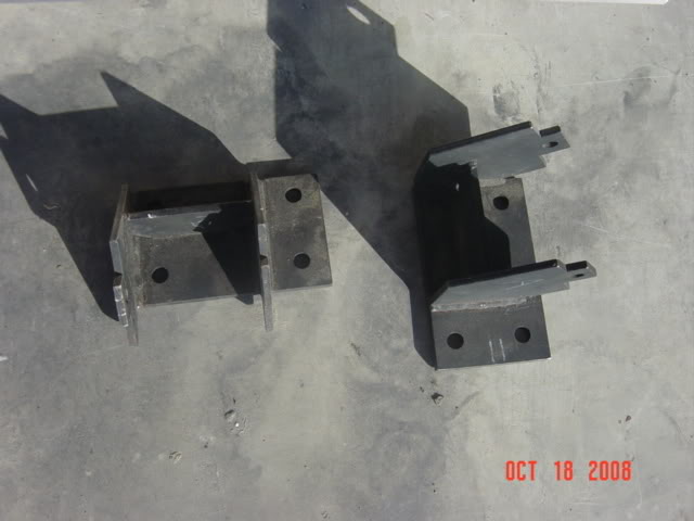

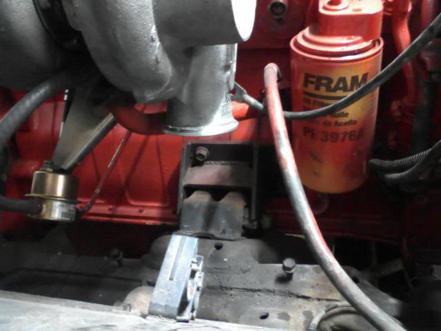

here what I have of the mounts and rail. not the best but all i got right now. I'll try to get a couple better ones from underneath tommorrow

Lookin great Luke.
Most of the motor mounts I have seen they are using the Dodge isolators from the First Gen Cummin's. With the ones you are using incorporate the GM mounts. I feel with this you can urethane after factory mounts. Care to indulge who you got them from?
Looking forward to see more information from you on this.

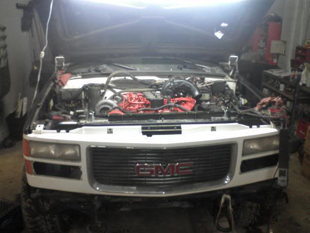

hey glenn, I got the mounts from "crewcab59" scott @ Tennesse Diesel conversions. very bolt in. no body lift no frame notching.

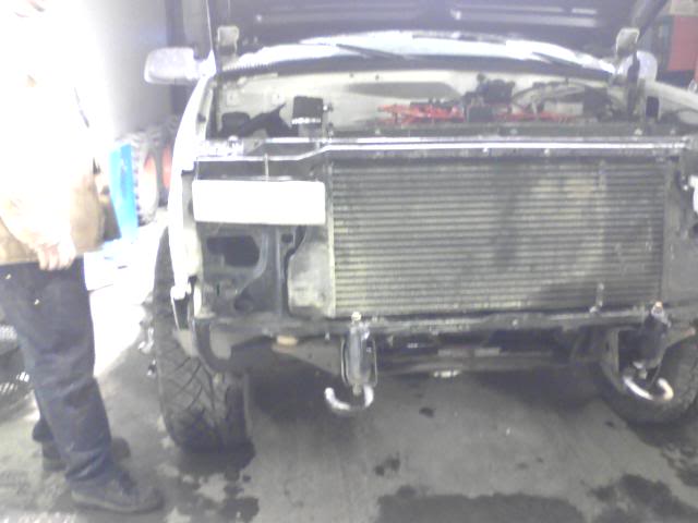

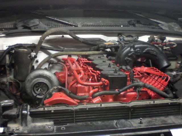

I used the rad and intercooler out of the '95 the rad is so much bigger than the GM one I just had to use it. and fits around the intercooler perfectly obviously. it is a tight fit with the CAC between the headlights. had to cut alot of the rad support out to fit. and have to reinforce whats left.
there is some lean to the rad and CAC but the stock GM rad clamps still work. the rad will not come out the front without removing the headlights. or pull the rad and CAC as a pair out the back.

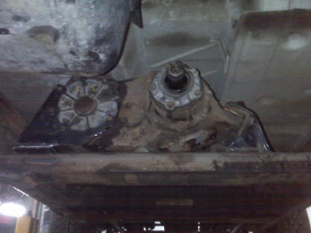

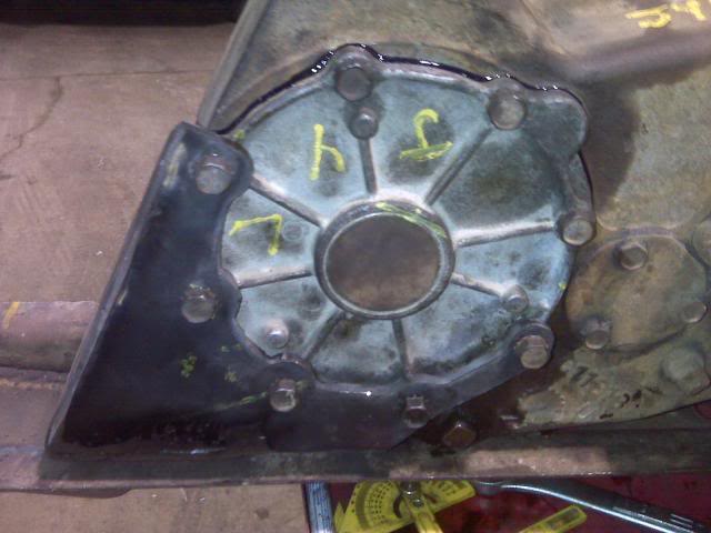

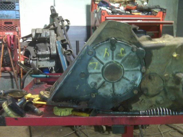

heres the divorced Ford NP205 mount. got it final installed last night. used 3 of the 4 OEM isolators. 3lb sledge for custom clearancing floorpan. grind 2" off the top of the driverside case mount to clear.

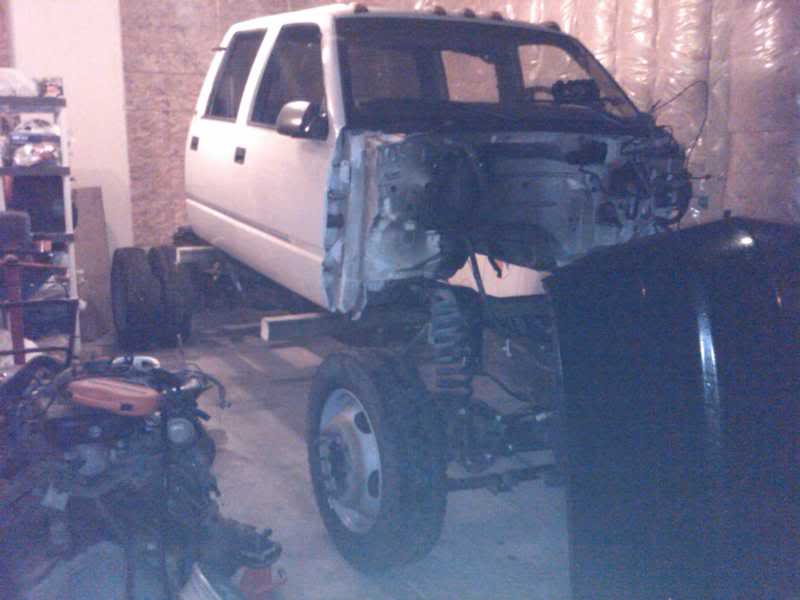

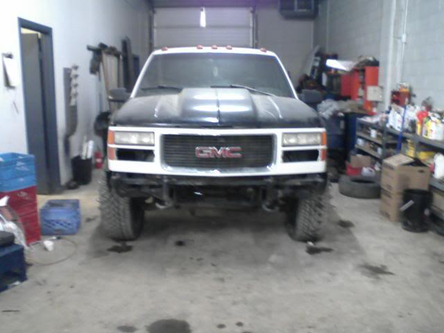

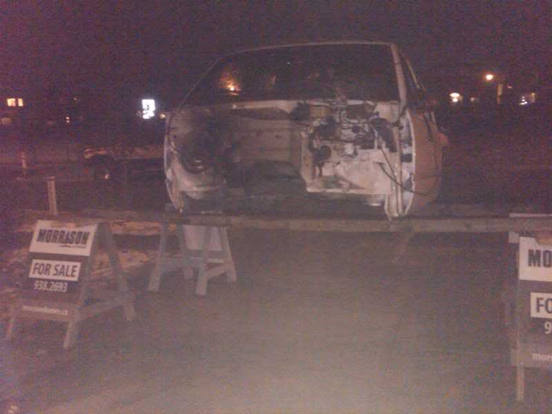

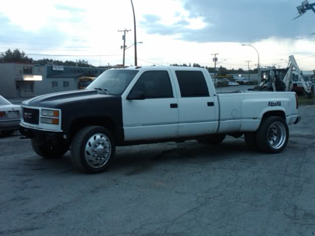

Oh works good. had it in there 9 or 10 months, then my OCD (Obsessive Compulsive Diesel took over) so I ripped the truck apart. and an putting my cab box and driveline onto a 2006 F450 4wd chassis.

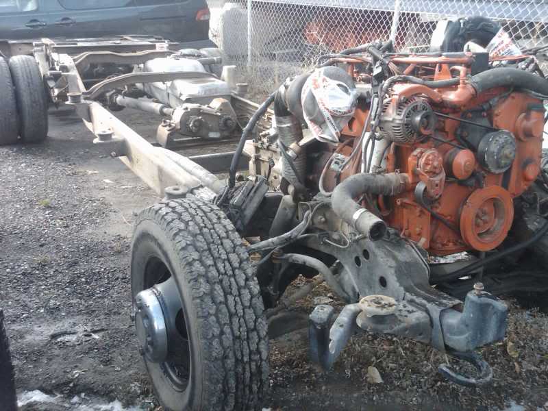

so another field tech rolled is service truck. company is self insured. so we parted it out. I bought the whole rolling chassis cheap. no damage.

WOW, that is a real bad case of OCD. You are going to confuse a lot of people when that truck is finished. Ford chassis with a Chevy cab and a Dodge engine/tranny.
Nice job!

Ya the old Albino Rhino is more like Franken-Truck
