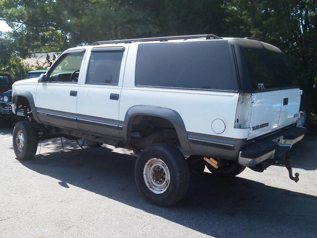

may be right behind you if i find a cummins donor truck......just got this 99 suburban back today body and frame only......drivetrain was gutted for another project....sold this to a buddy back in 07...he did the sas and only put 15k miles on it....sold it back to me for scrap price
