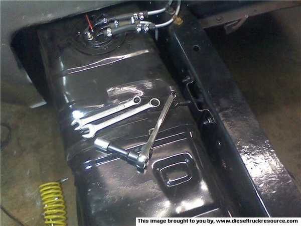

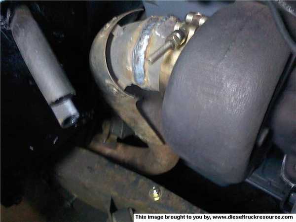

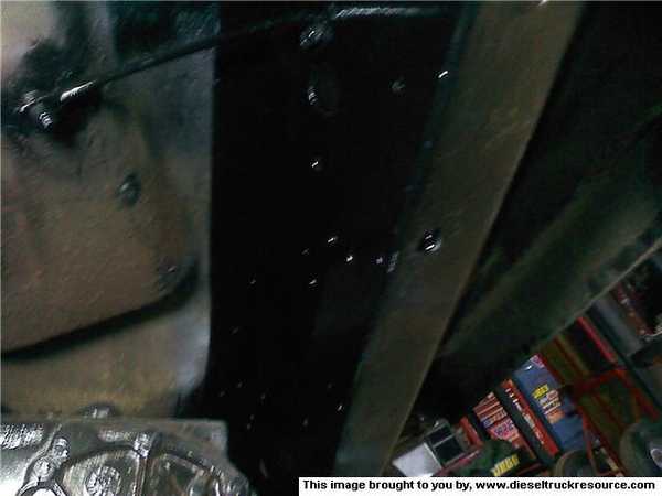

here's a picture of my exhaust, the factory first gen exhaust works almost perfectly for my chevy, i had to cut an 1 1/2" out of the pipe directly after the turbo and keep the same angle to make sure the pipe would sit on the turbo properly....i also had to modify the "exhaust bellhousing mount" to give proper frame clearance but it looks great....
and one of my freshly painted frame, and one of my new fuel tank.....with new 3/8 feed line all the way to the lift pump...
