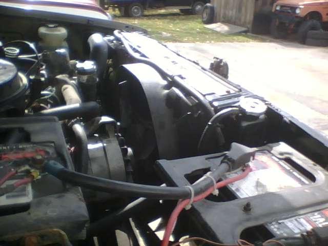

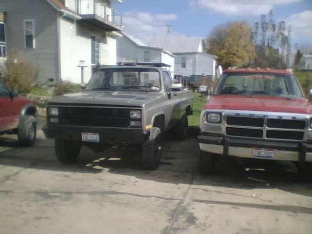

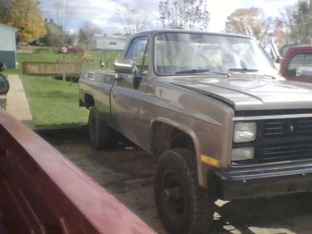

ok gentlement i decided to start doing my little write-up on my cummins swap...i have a 92 dodge W250 with a getrag that i'll be using as my donor truck and im swapping into an 87 chevy V30...the truck is actually an M1008 military issue chevy....but you won't be able to tell that when i'm done....the chevy has a 6.2 diesel v8 TH400 trans and a NP208 transfer....all that is gone!....i have to wait for the pics to be approved before i can post them up i'm assuming but i have some pics of both trucks to get this thread rolling!

i have a few things figured out already as far as how im going to build the truck.....i'll be using both the chevy axles dana60 front and 14bolt rear with 3.73 gears that i still need to find....the chevy has 4.56 gears now....can't have that! i'm keeping the chevy hydroboost brakes and with the huge 14bolts rear drums is an awesome combo!....the wiring is going to be the toughest part for me even though i know theres nothing to wiring a 12v cummins but the grid heater will be interesting for me to figure out!....like i said earlier the chevy is tore down and ready for the motor and the dodge is currently getting ripped apart....so the project is well under way....i'll be posting more pics asap....let me know what you guys think!....heres one of my donor truck....

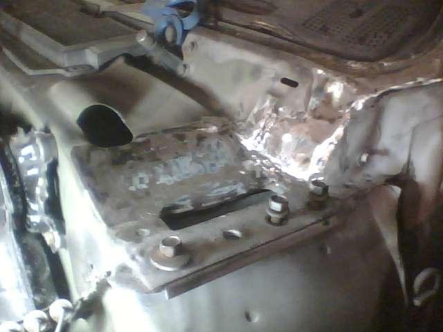

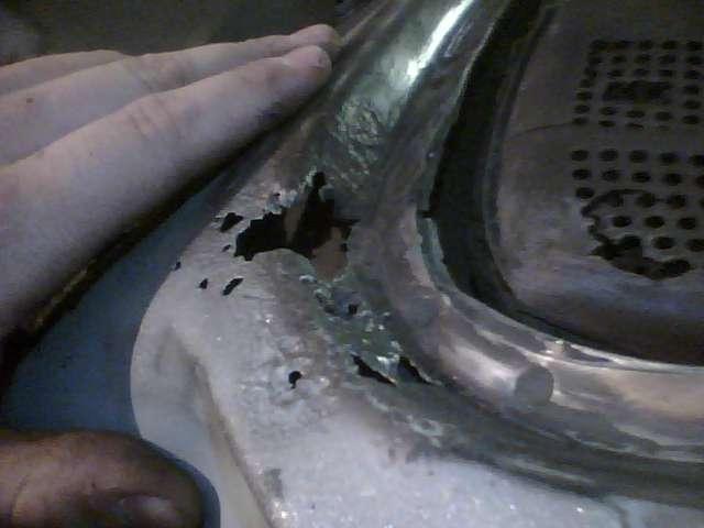

ok...after removed the front clip off the truck i was horrified with what i found! the first pic is beside the drivers side hood hinge, the second is the drivers side bottom corner of the windshield frame....after i tore the glass out!

so i did the right thing! i cut all the rust away and completely rebuilt all the rusty area......grounded it up and shot some primer on it.....i didnt pay much attention to makeing this look like nobody has ever touched it because its all completely hidden when the truck is together....so the cab is fixed as far as rust goes the cab corners and rocker panels are perfect..and even the passanger side windshield frame is too...

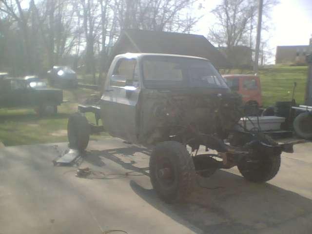

ok, here's a few most recent pics of the chevy.....the first one is the 6.2 diesel the TH400 trans and 208 tranfer on the floor and waiting for there new owner to come and pic them up!, the second is the chevy with the motor out and third is the chevy tore down just about as far as i'm taking it except the doors they have to be pulled soon....the last pic is something crazy i found under the hood....its got to have something to do with the glow plugs....lol this is a pic of it unbolted and flipped over it was mounted on the center of the fire wall....ill give a nickle to anyone that can tell me what that is
