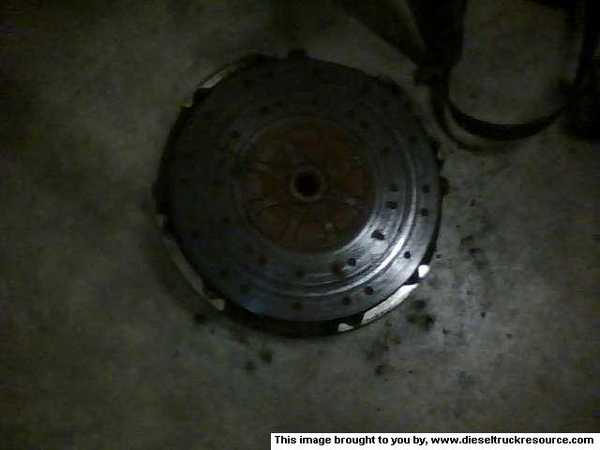

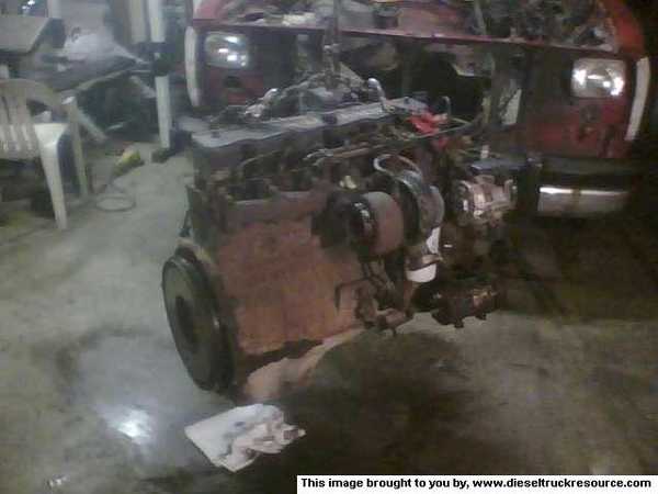

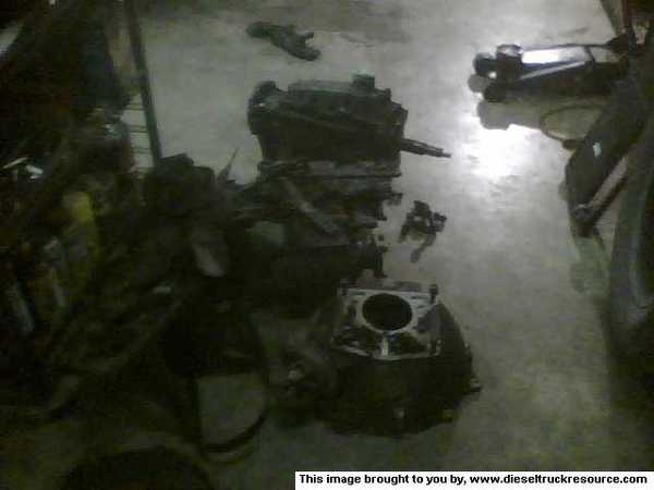

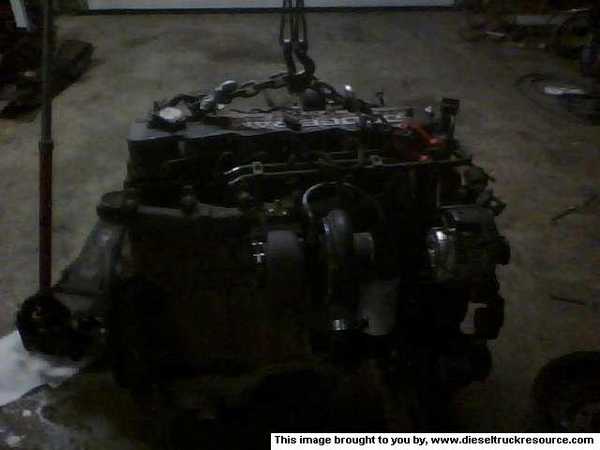

here's some pics from yesterdays tear down! a couple shots of the cummins on the ground, a big mess of greasy parts that i'll be spending hours cleaning! and a shot of my completely fried clutch! my pilot bearing was also completely shot....could this be causing my transmission to make a rattling noise in 4th gear under heavy load?
