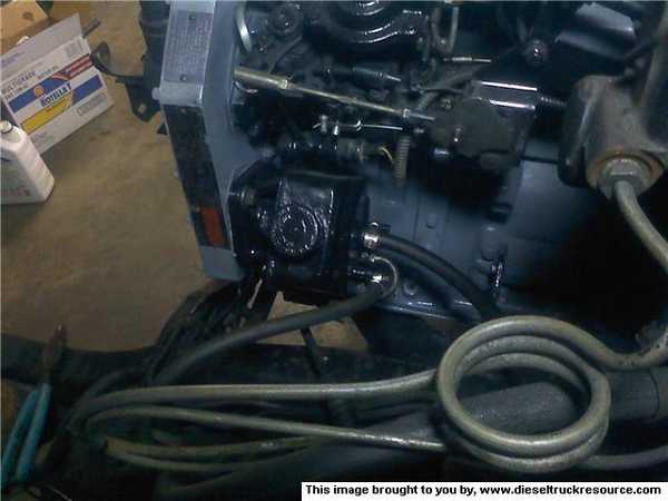

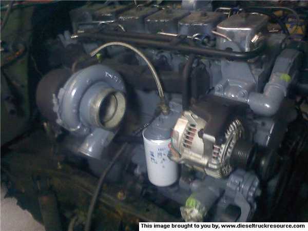

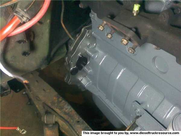

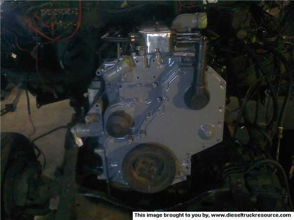

here's some pics....its finally in its final resting place after fixing several problems with clearance.....as you can see in the third pic the bellhousing bolts didnt have much room to spare.....if anyone has any questions or comments i'd be happy to hear them....

will you be able to take the tranny out later down the road if you were to replace a clutch? looks pretty close. Nice build-up!!

at first, no i wouldnt have been able to.....but i took the motor back out and massaged the firewall and transmission tunnel.....with a 12lbs. sledge and now if i drop the transmission crossmember it lets the motor rock back just enough that i can get them....thanks!
