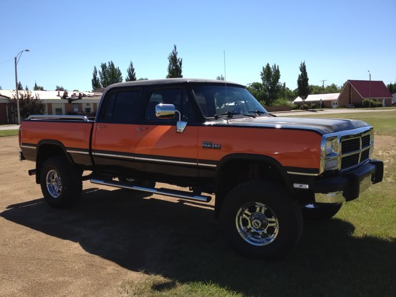

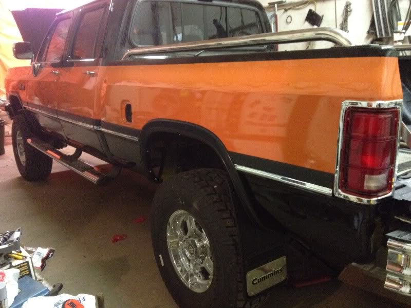

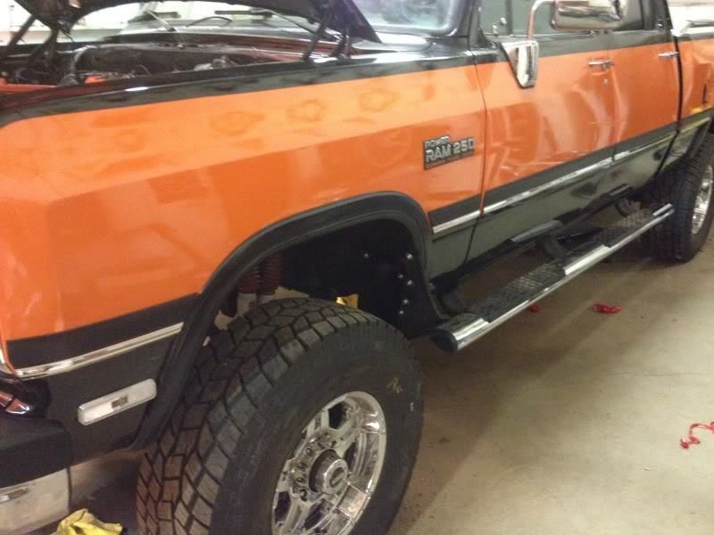

Got the mud flaps and body molding installed, now it's clean up time

That molding ties in really good with the overall truck, nice job!!

Dang that looks good with the new moulding! How was it contouring it around the post behind the back door? Will you post a picture of that when you get a chance?
Sent from my DROID4 using Tapatalk 2
Old Jul 2, 2012 | 07:29 PM
  #200
gyman98's Avatar
Posts: 1,437
Likes: 208
From: Saskatchewan
It wasn't bad at all, the new stuff is pretty flexible and has 3m tape on it which sticks like $&$! on a blanket. The factory LE molding stops just before the angle and that's where I stopped too.

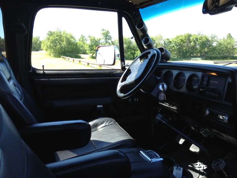

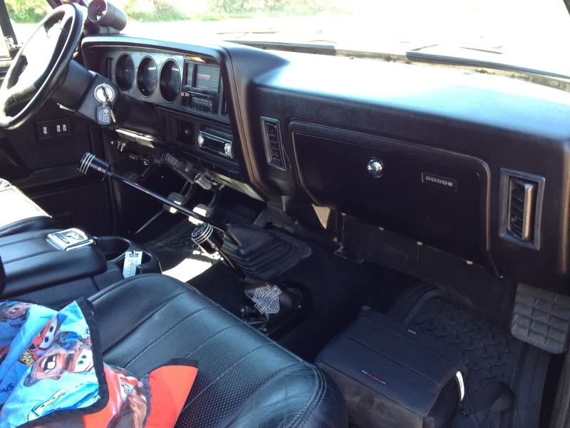

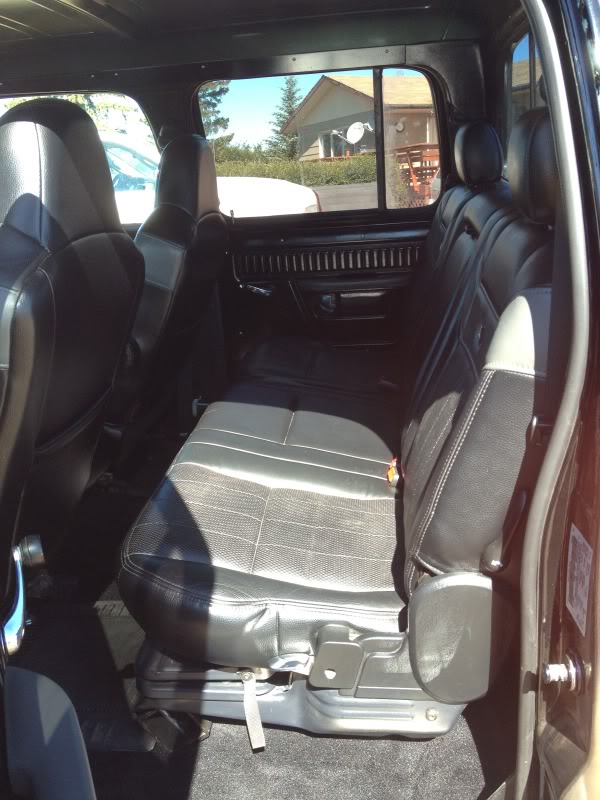

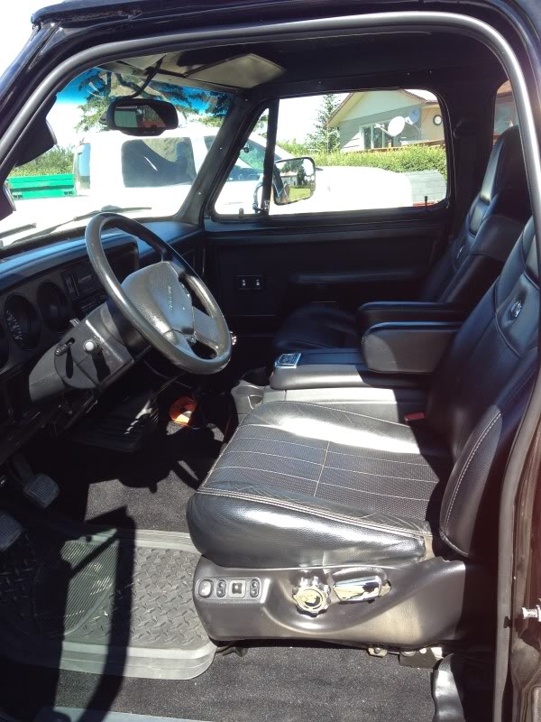

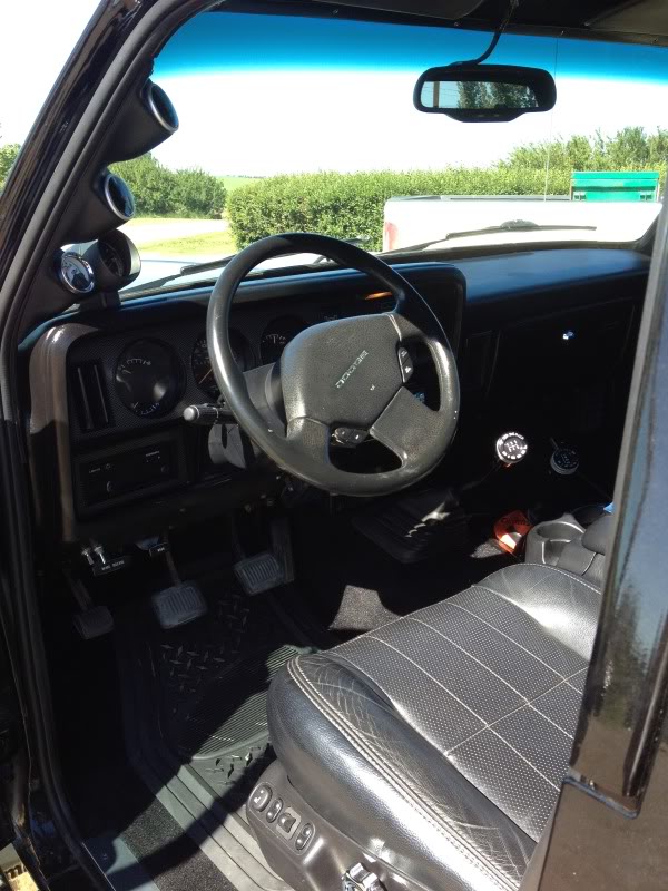

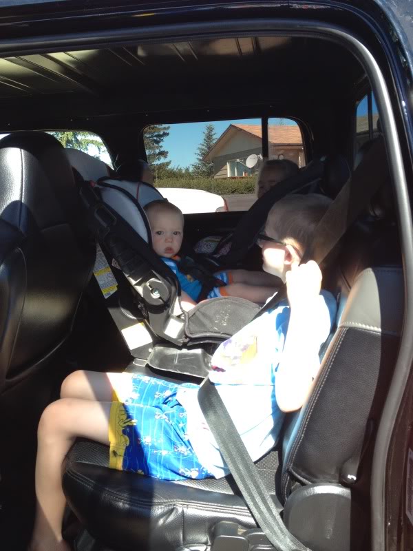

Cleaned up the interior a bit this morning and loaded the kids up and headed into town for their swimming lessons. Fits the family very well

wow that thing looks nice! the trim really makes it. how is it inside the cab for road noise? do all your doors seal up good?
Old Jul 2, 2012 | 11:46 PM
  #202
gyman98's Avatar
Posts: 1,437
Likes: 208
From: Saskatchewan
It's remarkably quiet, all the insulation I put every where must of done something! I can talk to the kids in the back seat easily enough, my wife says it isn't as quiet as my '11 diesel but it's close.
I adjusted all the weatherstripping flanges and then all the doors with the paper method when doing the weatherstripping. No wind noise today at least.

I have a few questions.
1) Did you use the donor wiring harness?
2) Where are those seats from?
Truck looks fantastic has been a real driving force to get mine done!
Thanks!
Old Jul 8, 2012 | 08:00 PM
  #208
gyman98's Avatar
Posts: 1,437
Likes: 208
From: Saskatchewan
Thanks!
I used all 4 wiring harnesses from the donor, the cab harness needed to be lengthened.
The seats, seat belts and console are from a 06 F350 Harley Davidson edition.
And thank you! Do you have a build thread going?
