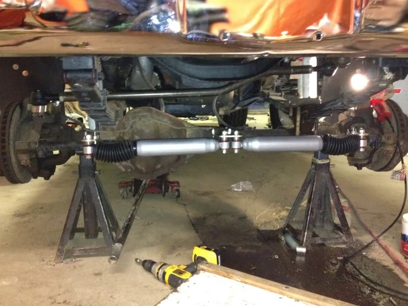

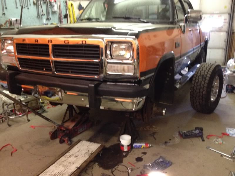

Put about 600km on it so far but really didn't like the way it steered. So time for crossover steering and dual stabilizers!

Who's X-over stuff did you use? Did you have to change out the PS gear box to a 2wd one?

Used northwest fab stuff, with the skyjacker pitman I had just had to turn it 90*. Used the same box but removed the bracket and installed it in the 2wd holes then shortened my borgeson shaft.
