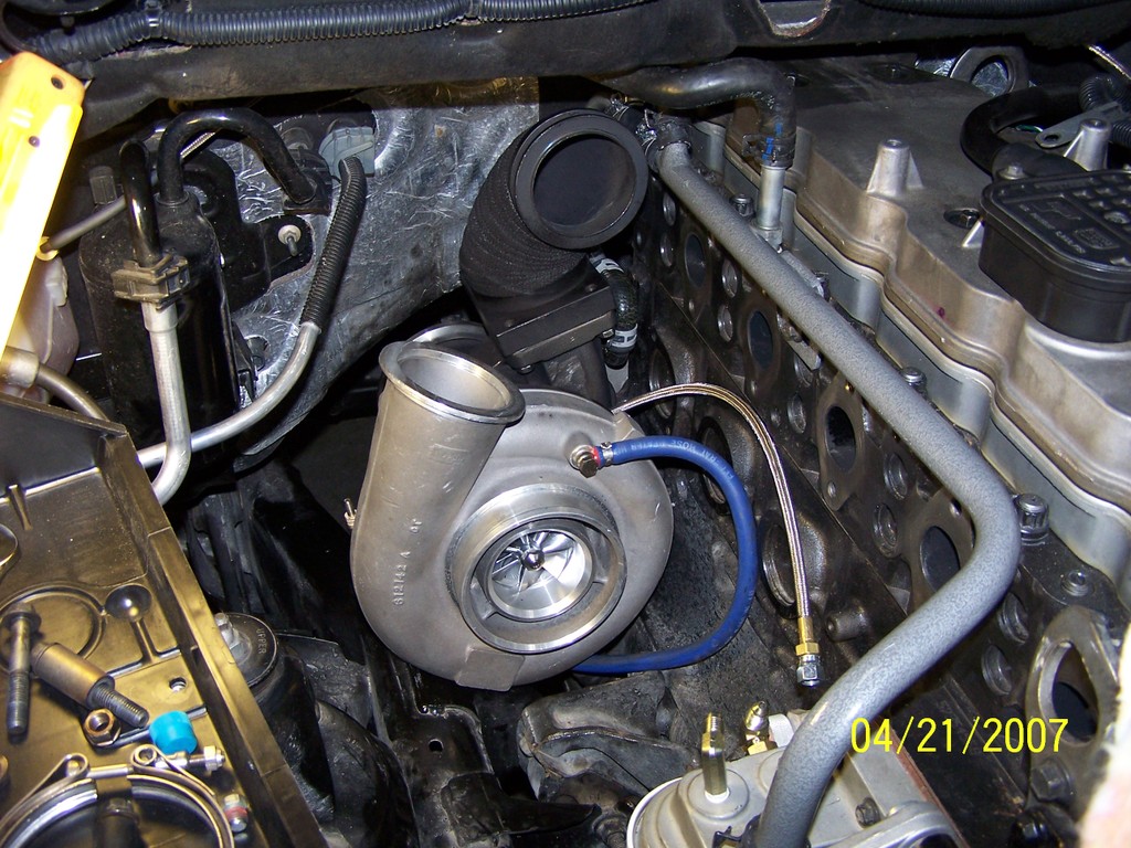

That heater pipe/cooler is total abortion on the CR automatic trucks. It's much better on the CR manual trans trucks.
For that heater pipe bracket that attaches to one of the ex manifold bolts, the service manual says to cut it off & then re-weld it when putting it back together.
While I did cut it, I fabbed a small bracket to hold it together with bolts.
This way if you are ever in there again, it's just a matter of unbolting/bolting it.
I did the same with the ex downpipe bracket attached to the bellhousing.
Some twins kit require you to bend & mod that heater pipe to make it fit.
The older style PDR/Industrial kit comes with a complete new heater pipe.
While it is really nice, it puts the heaterpipe up on top, in the way of the studs, water bypass kit if you have one, etc...
Here's a pic of the olde style PDR/Industrial custom heater pipe that came with that twins kit.
In the same picture you can see the A/C lines really nicely bent out of way.
I bent mine a little by hand, but wish I could have gotten them completely out of way.
The BD & Source twins kits use some spacers to move the A/C drier/evap away from the turbo's. It doesn't really work.
That kinda similar to what I want to build, just using stainless tubing and swedgelock fittings. Move all those rubber coolant lines out of the way from those hot turbos. I also plan to relocate my 2010 heat exchanger to up front, just for easy of repairing it. My 02 is a dream to work on, as its already been adjusted.
