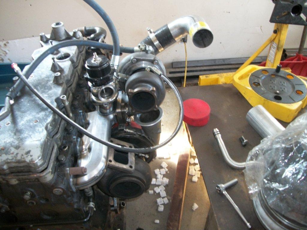

Just got the word from Forced that the turbos got shipped. Have most of the 03 truck twins mocked up, just need some time to install them. Probably only take a few days to finish that truck off. I can't wait, I'm pretty supprised that the twins set-up is very tight to the engine. Should fit any truck, even a 4th gen truck.
Sweeeeeet Mike!!!! There is tons of room to clear my coolant by-pass. Looking good but why are you up at 3:41 AM Mike???

That pic from Mike does look awesome. The external wastegate on the Steed exhaust manifold looks great.
Had to go to work. Been working some crazy hours as of late. Ya the steed manifold will give us clearance that we require for the bypass. I got the tracking number for the turbos, so hopefully we can get both truck done fairly quickly. The things we do for money. Funny thing is all winter, I had nothing for work. Now summer has arrived, its been fairly busy.
