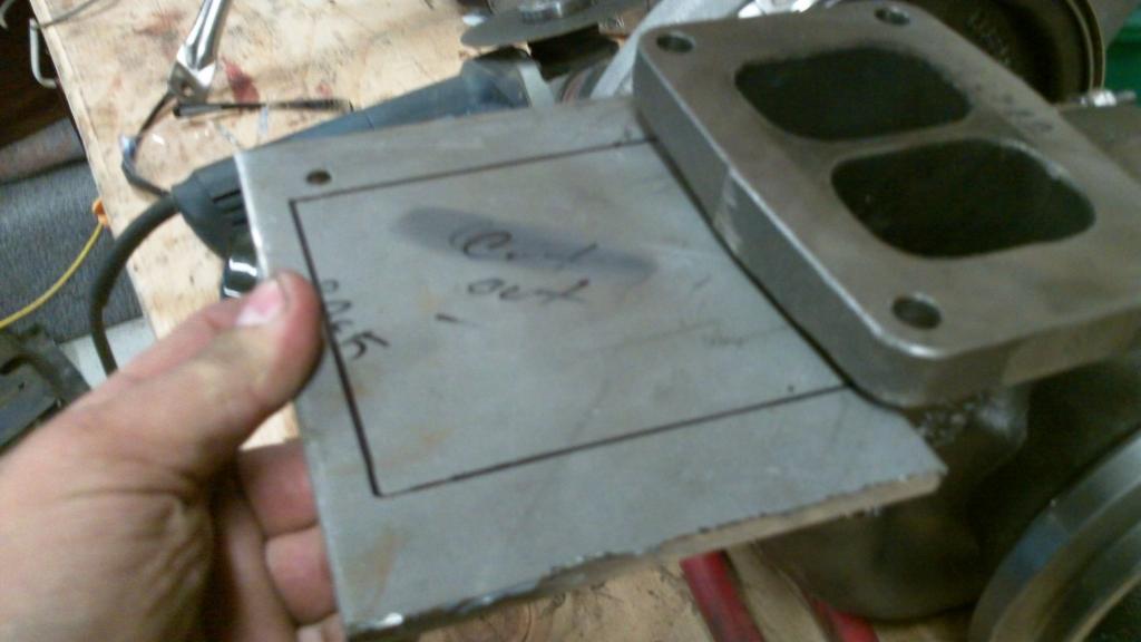

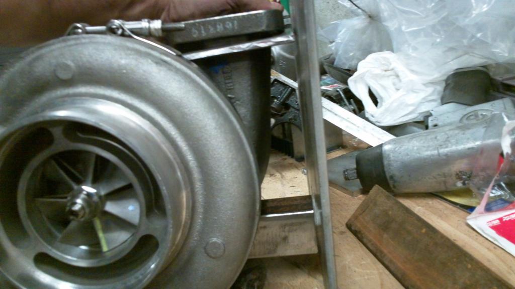

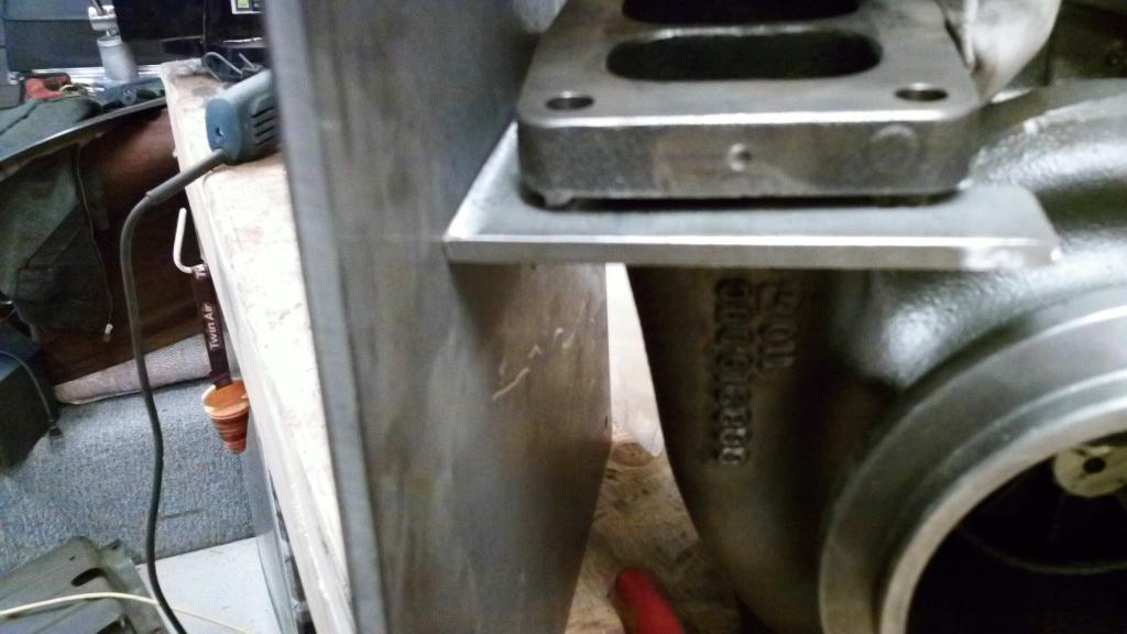

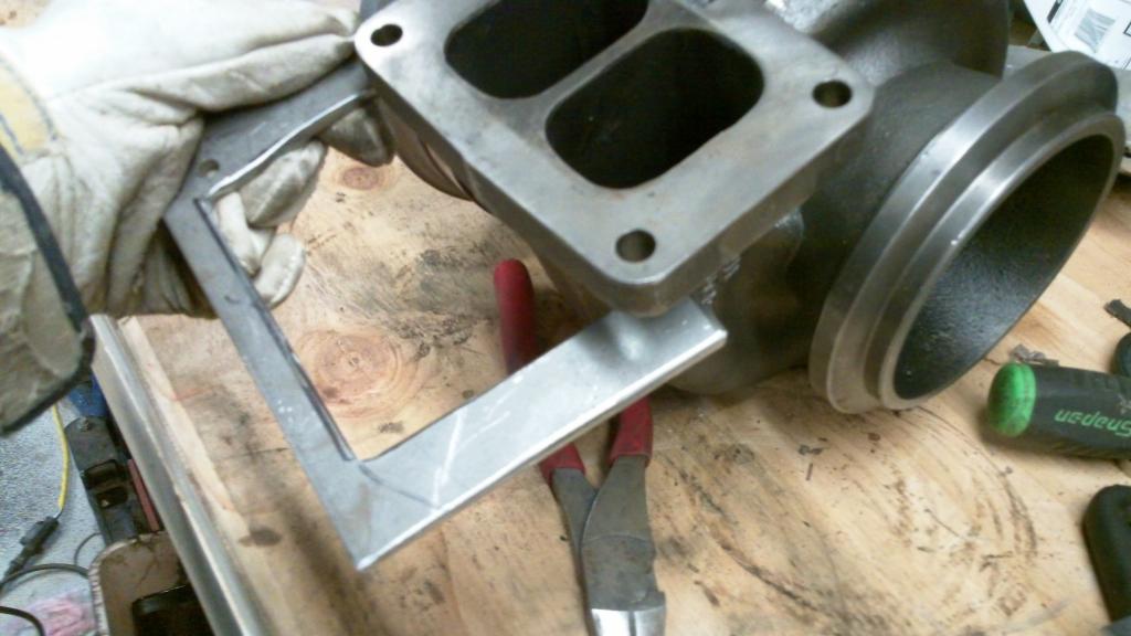

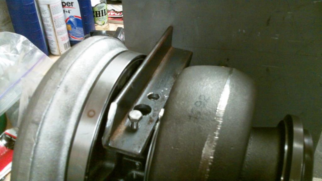

anyway heres the start
HE351/476
going to support the turbo by the t6 flange and the oil drain centre section.
pipe thread tap the angle for a nice AN fitting and stainless drain hose then use a gasket to seal the turbo/mount.
obviously gussets/bracing.. should be ZERO weight on the hot pipe
ANY SUGGESTIONS FROM THE PRO'S??
oh ya for the record..............i wanted small upgraded injectors got talked into a set of 5x18's.....dvstader......................tra nny grenaded...........and then mike hooked me up with a turbo to clean up the smoke.
so iam out $7400+ since august and its your guys fault
no hard feelings boys.
Attached Thumbnails Theres a trend with the twins thing. my project.-101_0060.jpg   Theres a trend with the twins thing. my project.-101_0061.jpg   Theres a trend with the twins thing. my project.-101_0063.jpg   Theres a trend with the twins thing. my project.-101_0064.jpg   Theres a trend with the twins thing. my project.-101_0069.jpg

I would support it on either the turbine housing flange or the CHRA drain flange, but not both. Lining things up can be a pain, and being able to remove the turbine housing when you need to is nice. Makes loading the turbo in and out of the bay easy when its half the weight.
good point. i was thinking "do it once" type thing. i always build overkill.
i just thought thats was alot of weight on just the flange
i thought i would make the main plate bolt to a bracket so the turbo is always mounted to the plate.

The single support will be enough. The hot pipe will add some rigidity as well. The nice thing about using the turbine housing to take the weight is you can just slide the CHRA in and tighten the V-band, makes installation easy. Also makes the turbo drain gasket easy to change if need be.

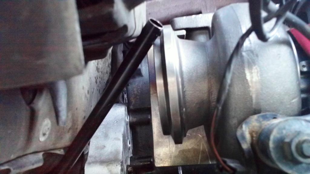

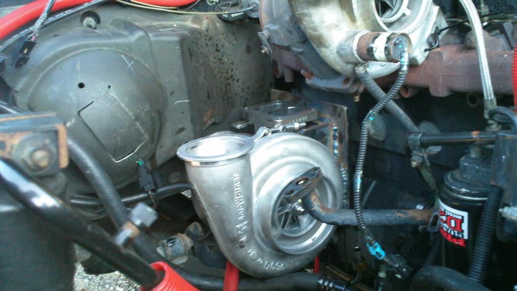

made some progress.
should have the turbo "mounted" in a couple days
still waiting on source. the piping should be pretty quick
going to have to trim a little heater box insulation.
what fitting should i use for the primary turbo drain? Are you guys putting it into the pan?
and can the pan be removed without lifting the engine?.
Attached Thumbnails Theres a trend with the twins thing. my project.-103_0076.jpg   Theres a trend with the twins thing. my project.-103_0079.jpg
