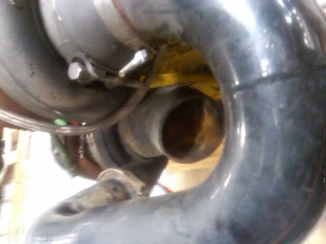

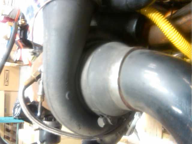

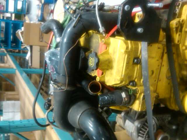

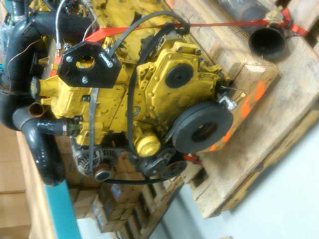

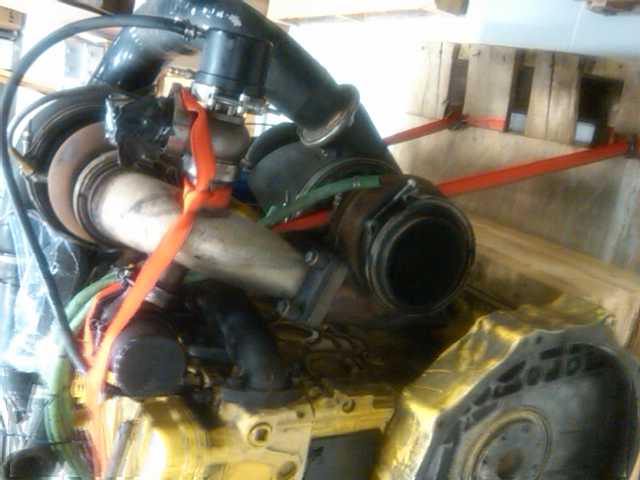

Is the primary inlet facing rearward? The exhaust is facing forward? Looks like one of gates dumps right on top of the valve cover. Did it come with an injection pump? I would check the welds on that one gate that was used for a strapping tie down.
Looking good. So you gonna rip her down and swap parts off the other engine?

inlet faces to the front of the truck. I think that the one wastegate dumps straight up... probably through the hood beside the stack I am thinking. I am going to check all welds. (the strap is actually just the excess strap so that it isnt flapping around... I will be moving over my stage 2 cp3, my fuel rail and my ecu. I have to get a fluid dampner for a 6.7 my 5.9 one wont fit.

That is an ugly looking paint job. A nce deep blue will look good on there. Time to bolt your stock flex plate on there and let it rip!

Turbo specs are:
top charger is a 75/83/1.0 t4 bottom charger is a 80/88/1.32 both are gated with 50mm ED gatesth twin 50mm external wastegates
Old Nov 30, 2009 | 04:35 PM
dvst8r's Avatar
Posts: 954
From: Airdrie, AB
Strange combo of turbo's. 75 over an 80 is really close in size. I am interested to see how it will perform. If I were the one sizing them I probably would have gone to at least an 88 primary, but like I said it will be interesting to see how they run.
Thats what I was thinking. A 71 would probably be more appropriate where the 75 is, or like you said, make that primary bigger. Wouldn't be much point in running high pressure from the primary with compressors that size.
