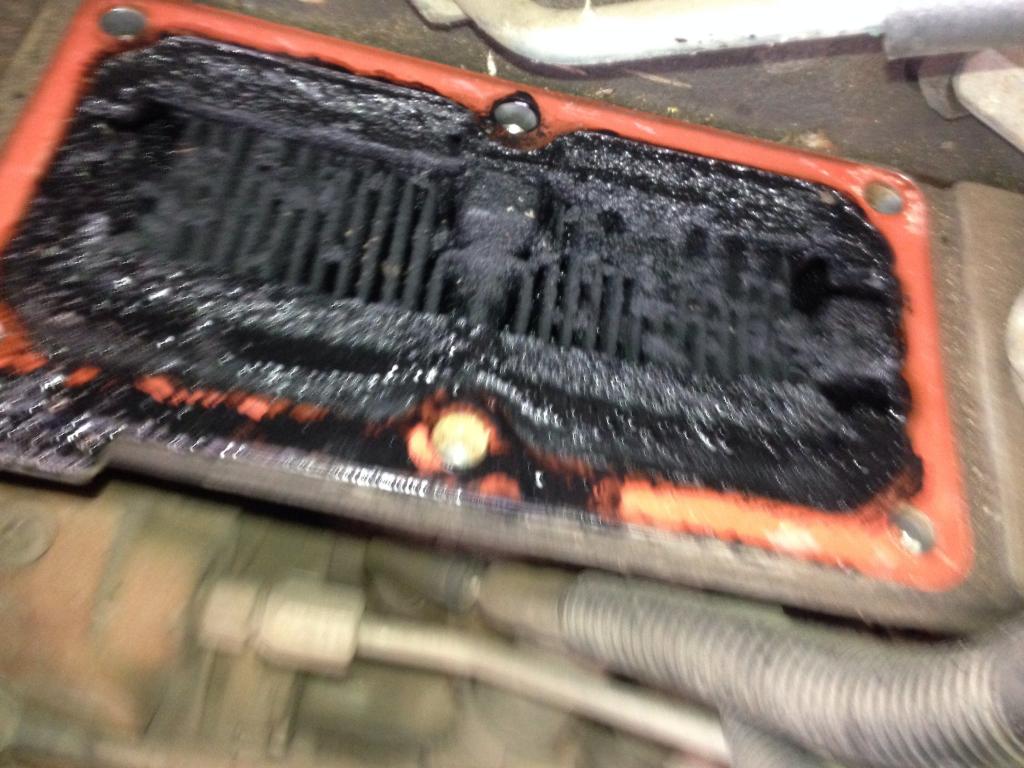

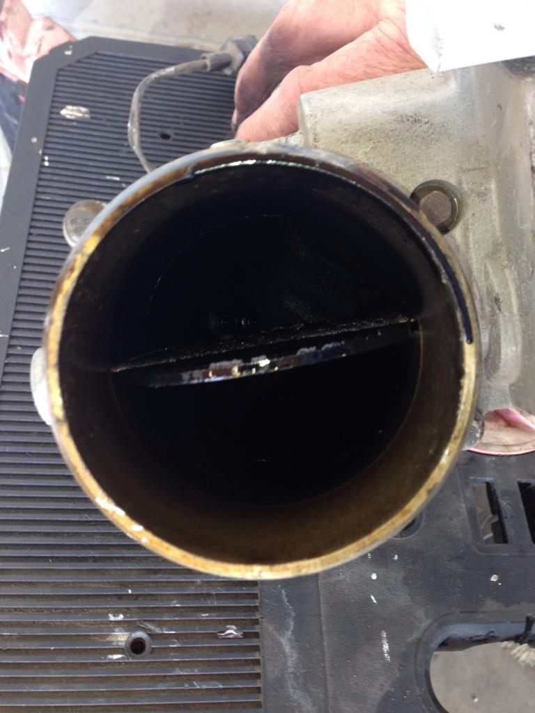

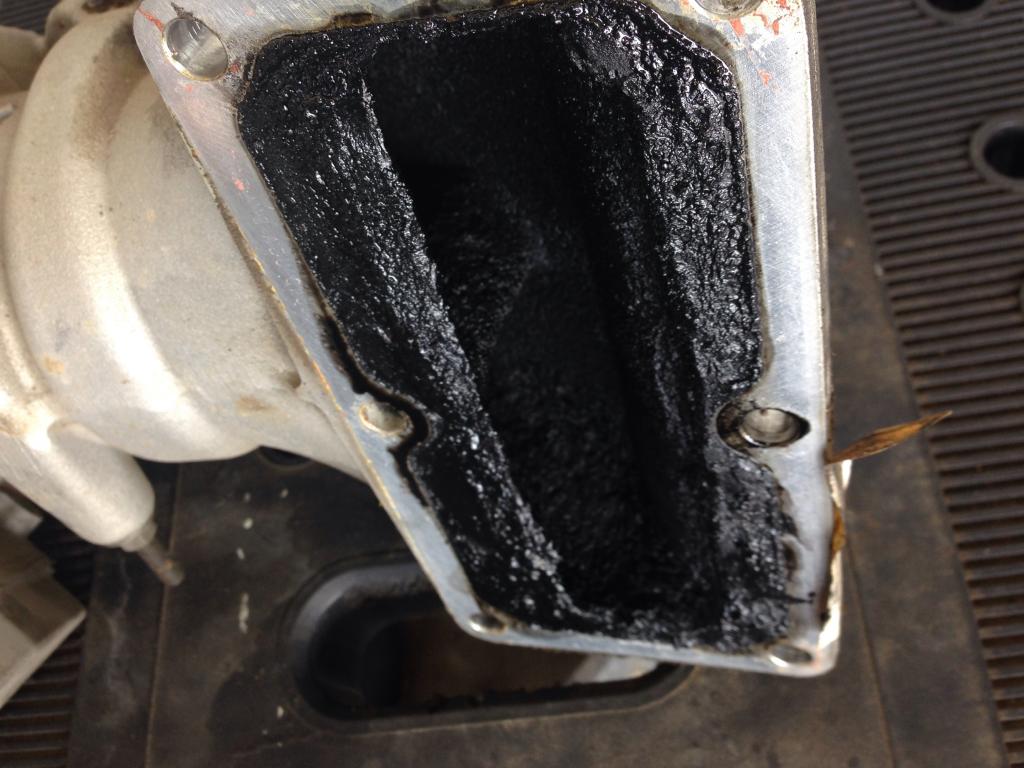

Now this is what I call sooted up.
Attached Thumbnails Did the required egr/filter maintenance-bills-002.jpg   Did the required egr/filter maintenance-bills-007.jpg   Did the required egr/filter maintenance-bills-008.jpg
I donno seems like an O2 sensor problem.

Some people just shouldn't own a diesel vehicle. Driving with CEL on and adding a gallon of oil should have been his first clue something was wrong.
The "o2 sensor" thing was what the dealers were saying at the beginning instead of removing the intake for a look, even pulling the MAP sensor would tell the story, and having to ADD oil??? it was more like having to remove it as it was making it. I took pictures into the dealer and to my surprise it didn't phase them one bit, they had already seen the problem just weren't admitting it. You are right that some people shouldn't own a diesel that's why a lot of fleet owners are going back to gas, in fact the pipe line company my BIL works for never did switch to diesel, they have only ran gas trucks, I used to think they were crazy but after seeing the problems with the 2010/2012 trucks they are definitely making the right choice. I would have thought that Ram would get it right for the 2013/14's but they are almost as bad and you have to add DEF to boot.
