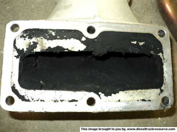

To do deletes or not to do.. Have a look at these photos it will make your mind up for you.
[IMG][/IMG]
There was more carbon than shown in the picture that fell on the floor as we removed the intake, truck has 30,000ml on it.
[IMG][/IMG]
Hard to tell in this one but the intake was almost completely plugged. There was also raw fuel running down inside the factory boost tube. The truck had been to 2 different dealers with the truck having no power and making oil, they had changed O2 sensors on two occasions. I plan on dropping by the dealer that sold the truck and did most of the work on it to show the pictures and voice my concern.

I do not own one of the newer trucks but am curious if that buildup is from a stock configured truck? Daily driver or Work vehicle?
That is crazy amount of carbon...
Best of luck with deletes.
The truck was completely stock except for a dealer installed fast idle, it belongs to my son and he uses it for work, it does long periods of hiway often pulling a cargo trailer, it is hardly ever in the city but he does idle it lots. I was just at the dealer with mine and spoke to the service manager about my sons, he told me that with the check engine light on for whatever reason the truck will NOT go into regen and will clog and carbon up very quickly. My sons is now completely deleted and I think mines next, I had a bunch of codes including O2 sensors. Mine has 7500ml and almost every single mile towing long trips.
Forgot to mention his MAP sensor was almost completely plugged as well.

I don't know how Busboy cleaned his but the Dodge Techs I have watched "clean" these intakes, EGR's, turbos used a small screwdriver to "chip" the crap off and then they sucked up the powder with large vacuums! One of the Techs there also used a high speed air powered "Dremel" type tool to grind the stuff out of there. He told me "John, this is almost like mining for coal!" The stuff is harder than you might think and IMHO it has the consistency of "Kingsford Charcoal Briquets!"
As I said, pretty dang disgusting........................
Dodge also has a solvent they use to flush the stuff out of turbochargers but many of them are so bad the shafts have broken in them!
That water cooled Holset Turbo on the new Cummins 6.7 costs almost $3,000.00 retail!!
