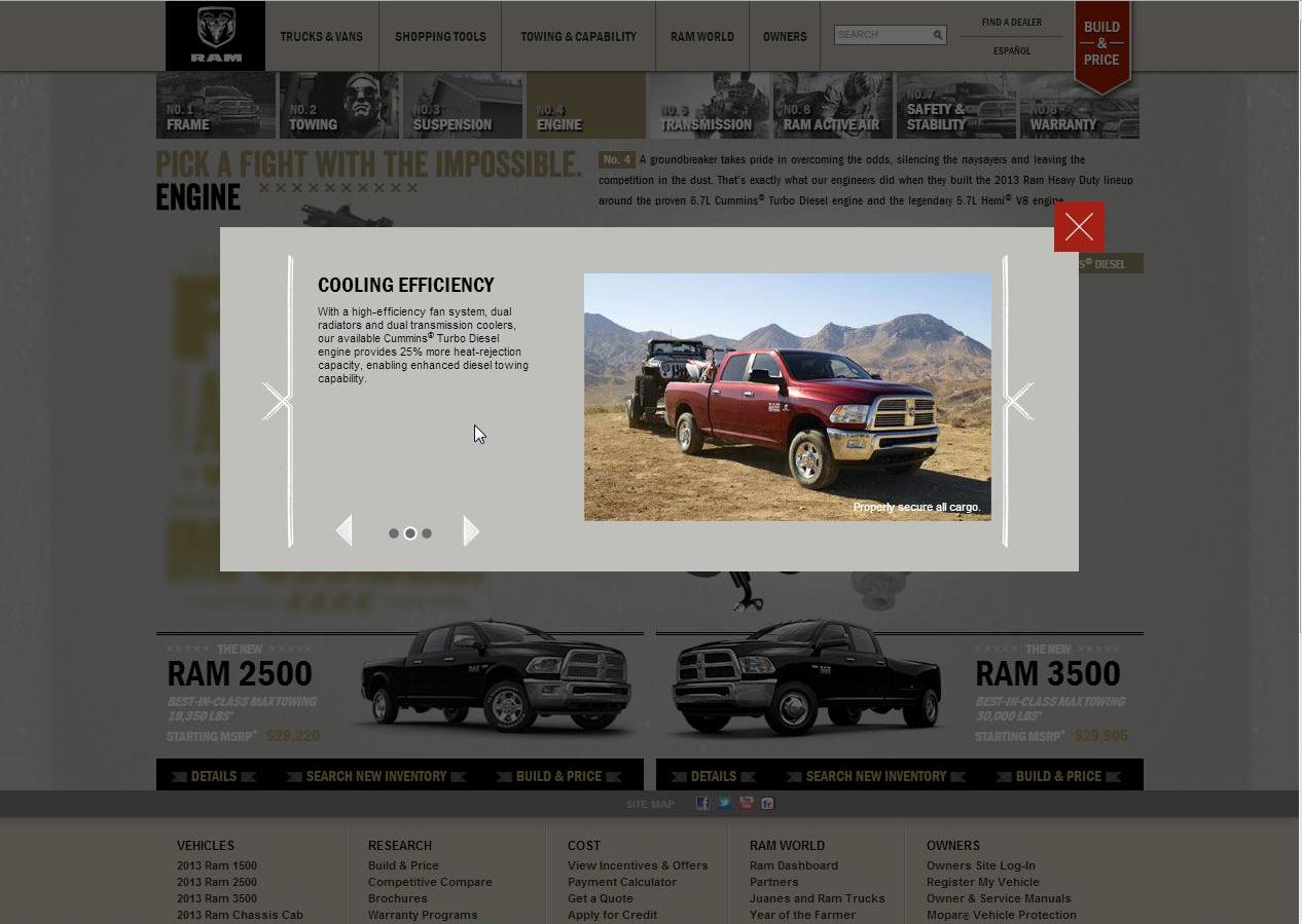

If you notice on the current ram web site, one big "improvement" they're toting is dual radiators. Not sure if the size changed but according to my dealer and STAR, they run them hotter than the 5.9. To me it screams "we have a problem with cooling and we just admitted it with this statement".
http://www.ramtrucks.com/en/groundbreakers/#engine
I was told to mat it and don't look back don't look down. Kind of reminds of a Jason Aldean song. lol
