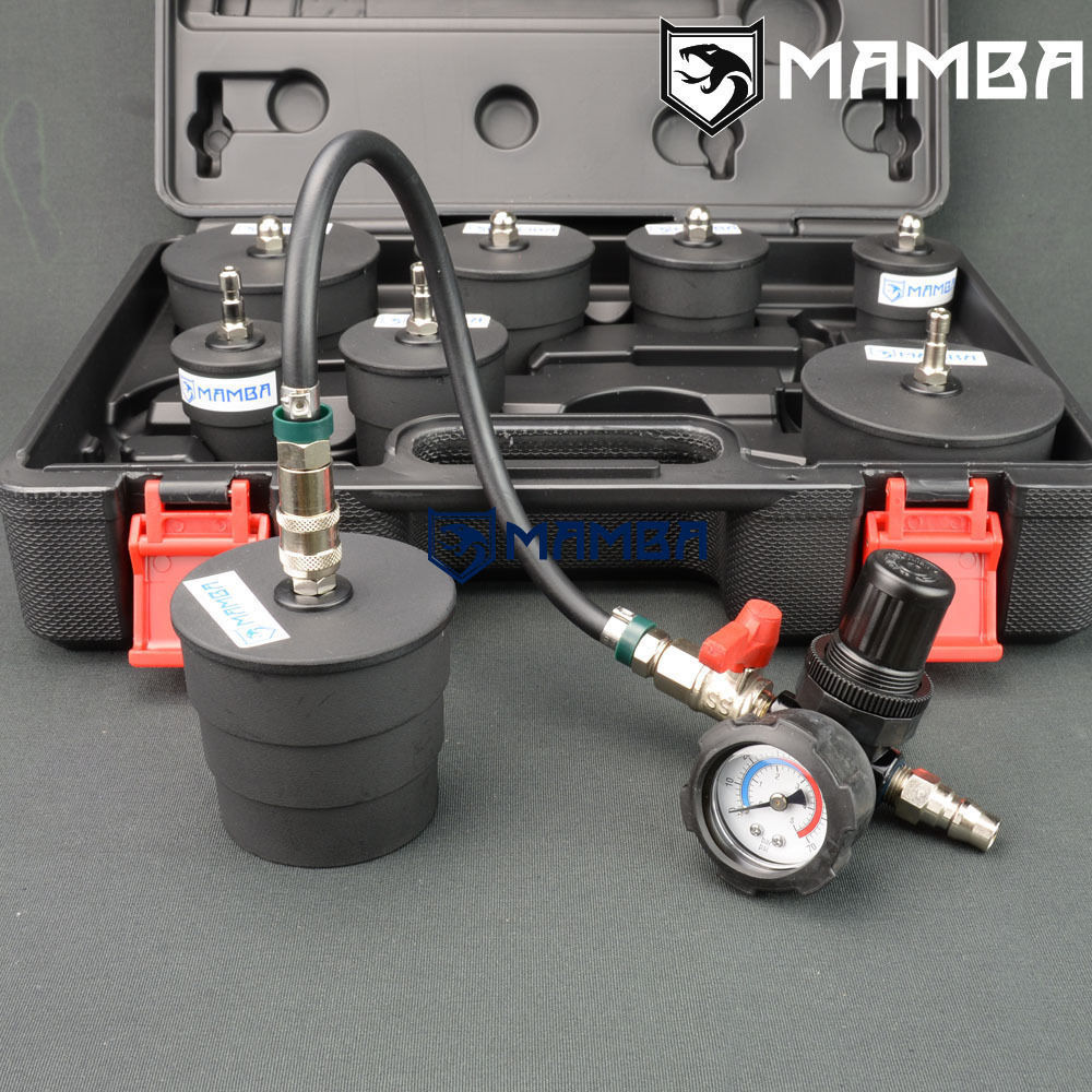

Boost pressure leak, check all hose clamps. I use a special miller tool that hooks up to turbo. Use soapy water and check all connections.
