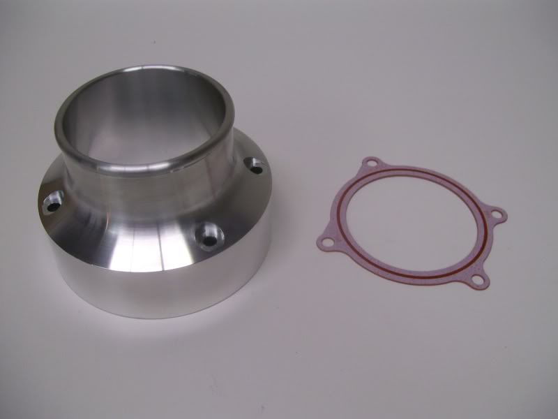

The Throttle valve delete is a physical replacement for the throttle valve that ensure it cannot close and cause intake issues. If you are full deleting its a quick and easy install and relatively inexpensive....
Throttle Valve Delete
It removes the butterfly valve and leaves ZERO chance of it accidentally closing.
This is a picture of a TVD (this is a Shibby, there are others on the market)
It replaced the entire throttle valve assembly shown here.
It is installed by removing the four bolts that hold the Throttle valve assembly in place, removing the boot clamp, and then reinstalling.
Here is a picture of it installed.
