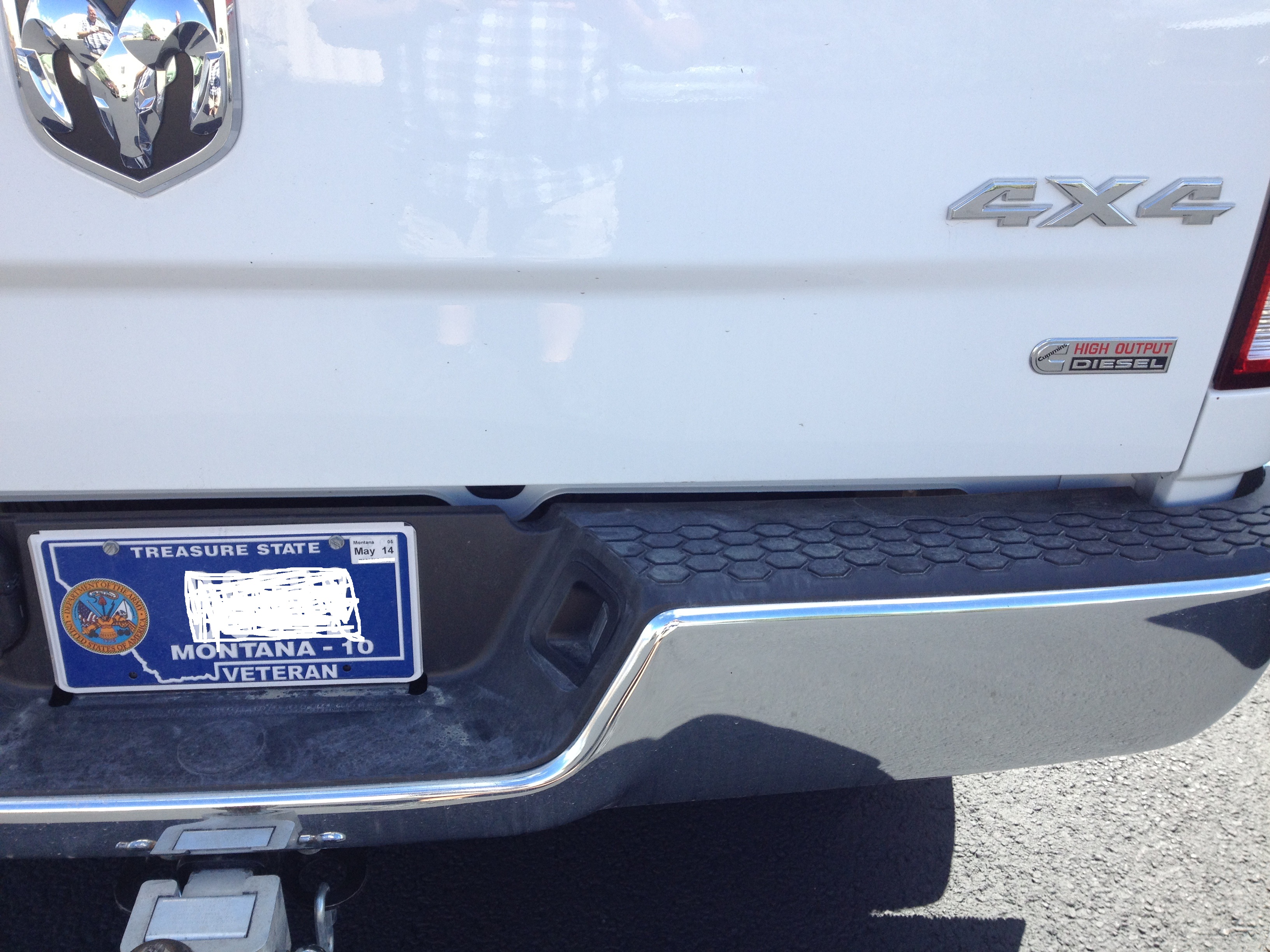

It will be on the right hand side of the tailgate bottom. It will say High Output Cummins Diesel. My truck is the HO and has 800 lb ft of torque.
Here is a picture of my tailgate for reference.

Thanks - I do not see the badge on the truck tail gate.
