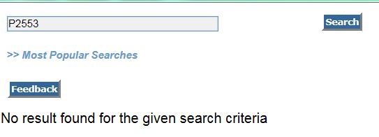

Old Feb 15, 2017 | 10:33 PM
BigIron70's Avatar
Cummins Guru
Posts: 4,191
Likes: 65
No such code according to Chrysler
