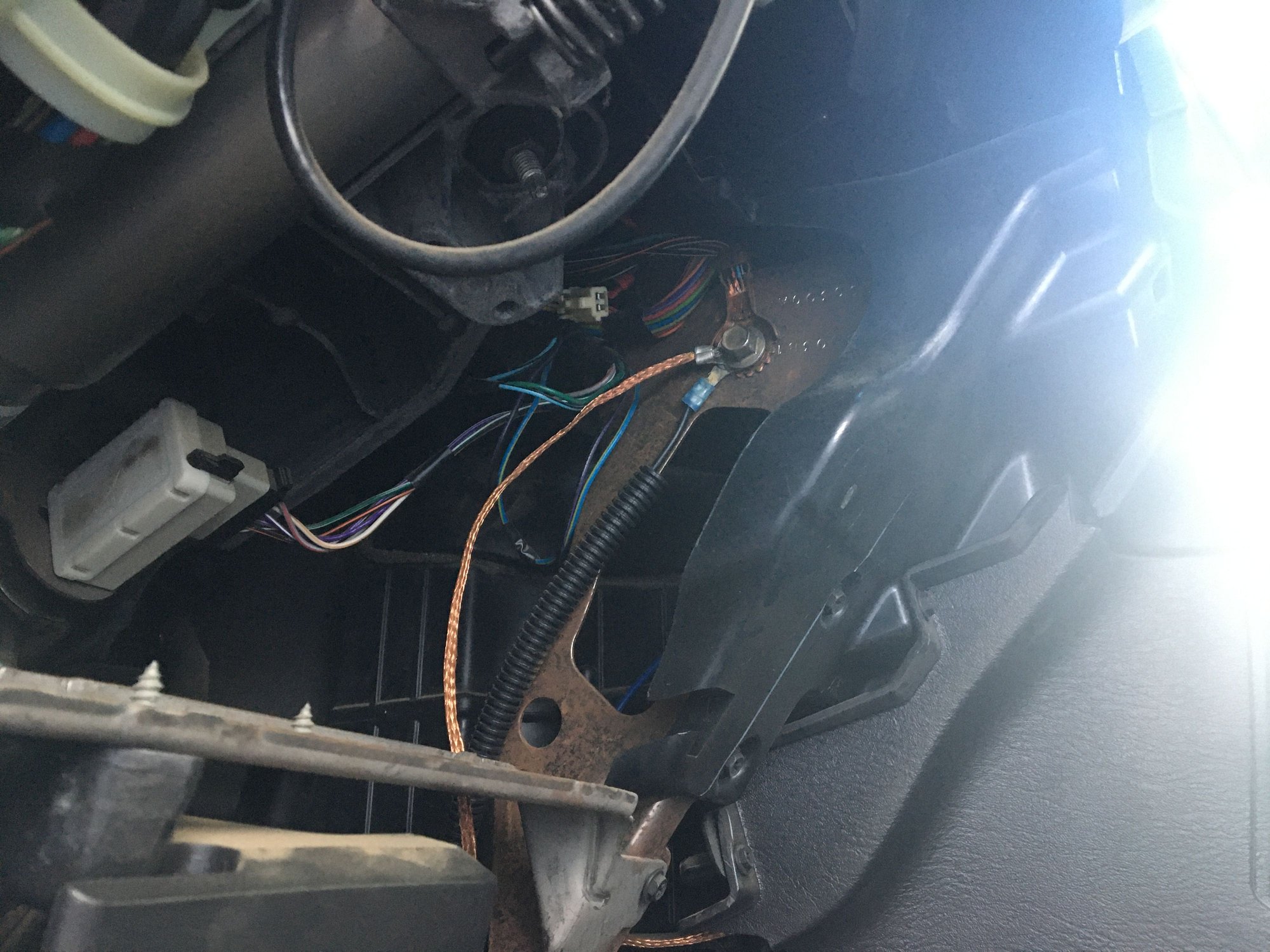

Check the ground under the dash. Polish things up and make sure it is secure.
I have no idea if this will fix your issue, but it is a solid starting point....
I have two extra wires on mine.
Braided copper drain for the two way radio and the single black wire in the loom for the PacBrake
Edit: This is under the steering column. You'll need to remove the panel to access (two screws)
Edit: (again) It also might not hurt to run a temporary separate ground wire back to the battery from this ground point. It is possible the entire dash frame is not grounding properly to the cab.
