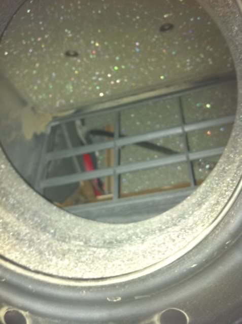

Ok I have some really weak a/c blowing out of my vents. I checked for mode door failure and when I have it on the dash vent mode, it only blows air out the dash vents, good right! When it's on dash vents/feet it blows out those vents plus the defrost vents? When it's on the feet vents, it blows there and also the defrost vents...what gives? I also, pulled the blower motor and the recirc door seems to be good. I've attached a photo of the recirc door(sorry for the poor quality pic). So maybe I need a new blower motor?
